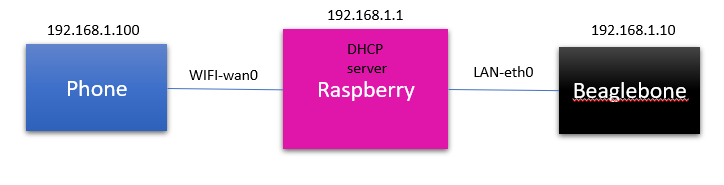

It is necessary to connect the Raspberry and the Baglebone by LAN in the same network. Through Wi-Fi, have access to manage these devices (ideally through wpa_suplicant (client)). Through the hotspot is also possible but less preferable.

My task is to do without a router. Use only raspberry
Yes its work, but my task is more difficult
What does this means?
hotspot and lan work as different devices, and I need to combine them. Probably in bridge and add rules to IPtables. But I don’t understand how
