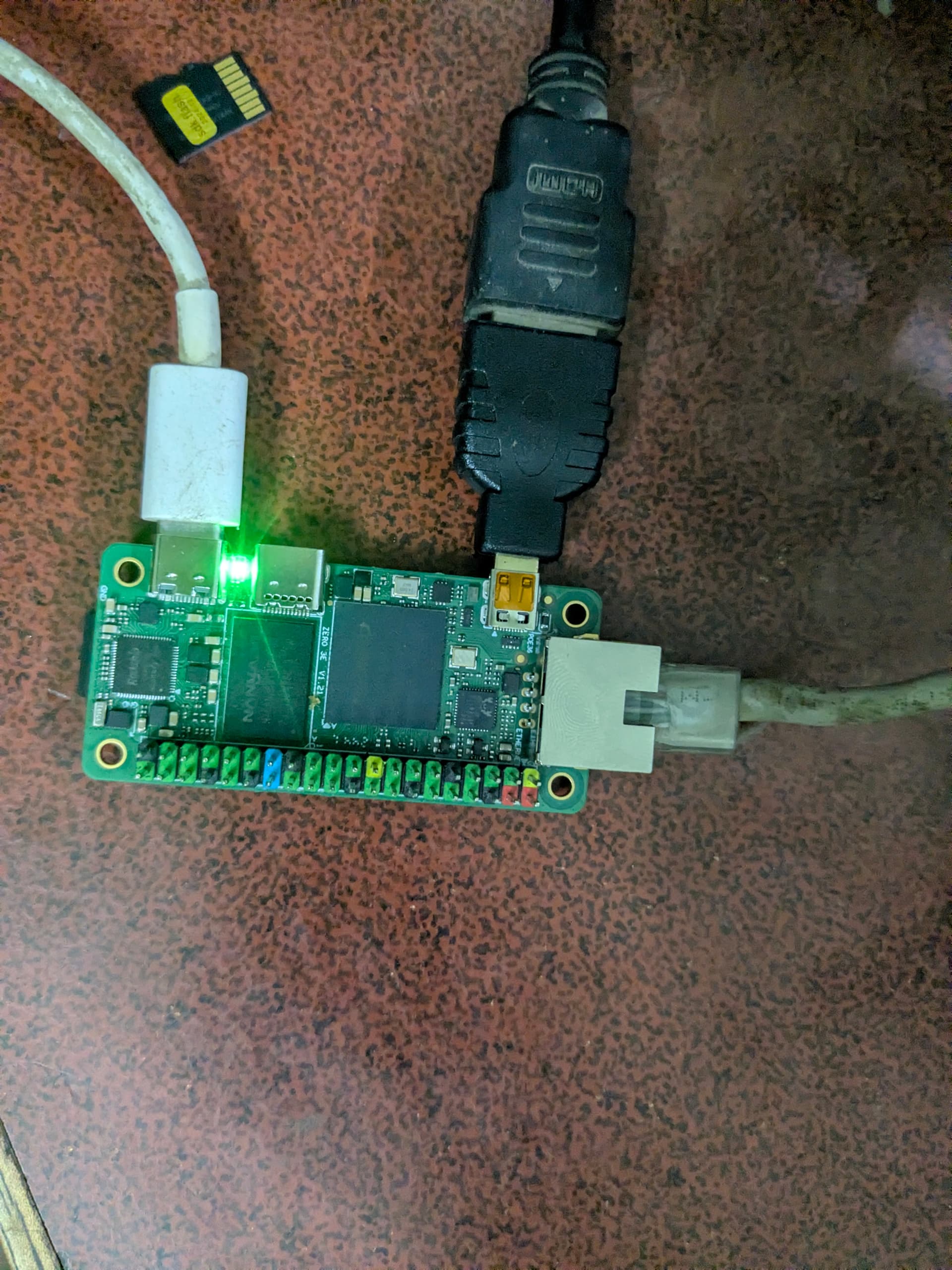

This is how the radxa is right now,
The led is constant and not blinking, it used to blink when i installed dietPI before as far as i can remember.
EDIT: The radxa is warm to touch as it would when it was booting to linux, and the SD card next to it on picture has the mainline linux, the sd card currently inserted had bookworm version.

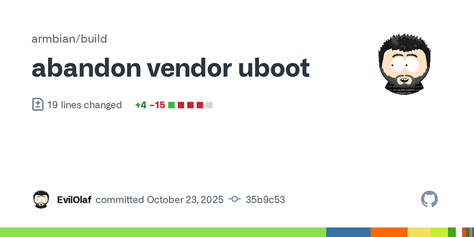

EDIT: Okay, issue this time is our end. The bootloader is looking for the non-existing 3E/3W specific device tree. We actually have a patch in place to adjust this, but probably the patch dir has changed. I’ll look into it and redo builds.
EDIT2: Jep, related to recent switch to mainline U-Boot also with vendor kernel:
So we need to define the device tree explicitly for the vendor kernel builds now. However, instead I’ll test the mainline kernel build now. Better to drop vendor builds entirely if mainline works well.
