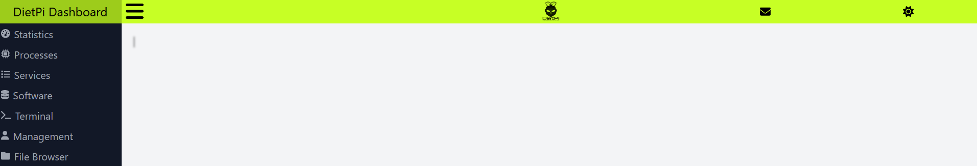

    Right now, I don’t have any “dietpi-services” open anywhere and I can also access them inside the terminal. However, the services tab is once again not accessible for some reason:
P.S. Well… it seems that while trying to bring all those edge cases to your attention, I’ve actually managed to somehow mess up the DietPi Dashboard even more, and now the general page of it won’t even load as well.
