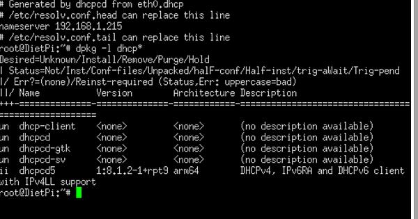

Can you share following
cat /etc/resolv.conf
dpkg -l dhcp*
You should remove the dhcp5 package if not needed. It’s overwriting your Static IP configuration
Is this the correct command: apt purge dhcpcd5 dnsutils
Yes but I would not purge dnsutils. Removing dhcpcd5 should be enough
Ok removed dhcpcd5 and am able to change DNS IP w/o issue but unfortunately the network test still fails and my Pi-hole still not working
