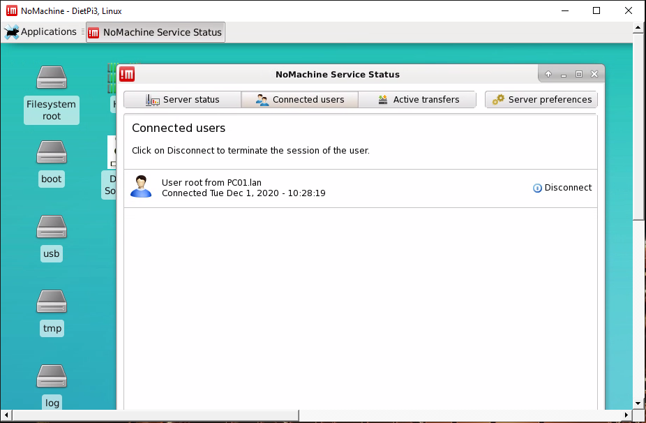

i uninstalled and reinstalled both xfce4 & noMachine.
i connected a monitor to it. xfce4 was running and i logged into the xfce4 desktop via noMachine with no issues. so far so good.
if i shutdown, disconnect the monitor, boot going headless, cannot access desktop via noMachine. i get that message about
“Cannot find the default environment. …”
the /var/log/Xorg.0.log had one of these message lines:
(EE) Fatal server error:
(EE) no screens found (EE)
i uncommented this in /boot/config.txt
hdmi_ignore_hotplug=1
i edited these as that's the rez i want with noMachine from a laptop:
framebuffer_width=1440
framebuffer_height=900
i did see an option for headless in dietpi-config under display resolution but i had already edited the /boot/config.txt. i assume it does the same thing?
i don’t understand why lxde worked as headless but xfce4 wouldn’t without the /boot/config.txt “hdmi_ignore_hotplug=1” edit.
anyways, it’s working now. thanks for your time and help!!! as always you folks got me running in no time!
