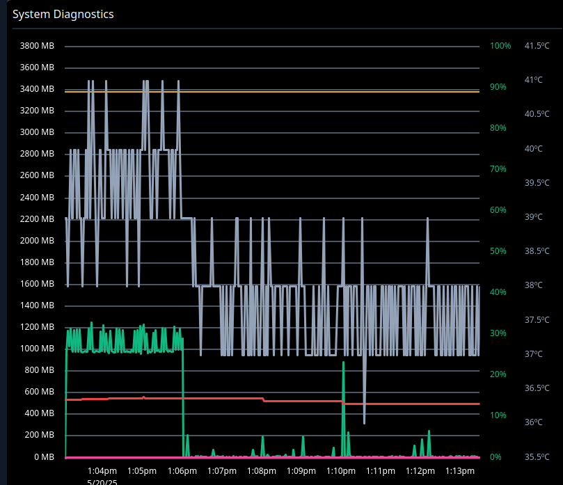

Dashboard and Fan

Current ambient is 20 degrees and PI dashboard says the cpu temp is 38 degrees.
The Pi 5 is in a waveshare case with nvme drive connector, and it has lots of room and ventilation. Currently at ambient temp of 18 in the basement it is running at 41 degrees, however it has been in use most of the morning. So far it is only when filling the database for ampache and jellyfin that it exceeded 50 degrees and only then it fluctuated between 48 and 52 or so.
