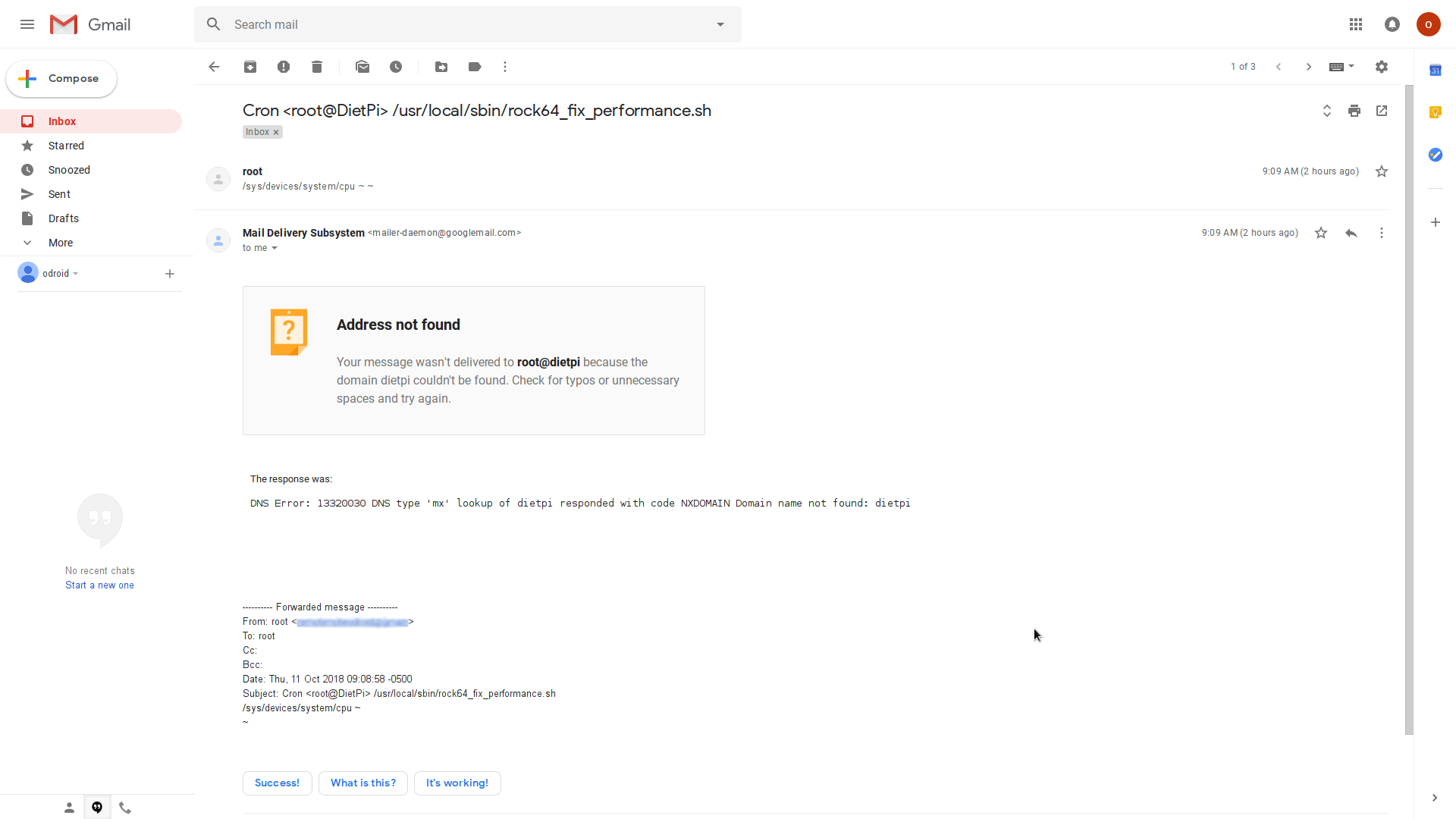

Cron <root@DietPi> /usr/local/sbin/rock64_fix_performance.sh
I have noticed that every-time I reboot my rock64, I get a cron’s email to my gmail account.
I have set up few cron jobs myself but even though they are disabled now, I keep getting this email from cron…
Could anyone help me out to understand this “strange” behavior?
I am attaching below my smtp.conf file

This is the cron’s email that I get every-time I reboot my machine.

Hmm, not much experience with local mails, but the default hostname on DietPi images is “DietPi”.
So if the mail goes to user@host non-case-sensitive, this would be root@dietpi.
So now you configured smtp with “hostname=rock64”, so is “rock64” really the correct hostname? To check: cat /etc/hostname
Also it is recommended to use the FQDN as hostname, e.g. host.domain.org
You can change it via: dietpi-config > Security Options > Change Hostname
