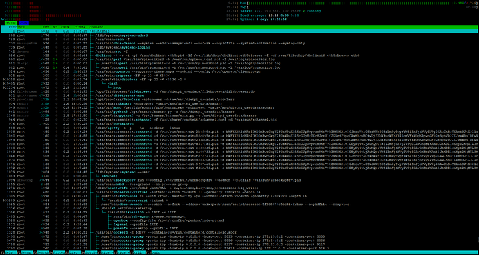

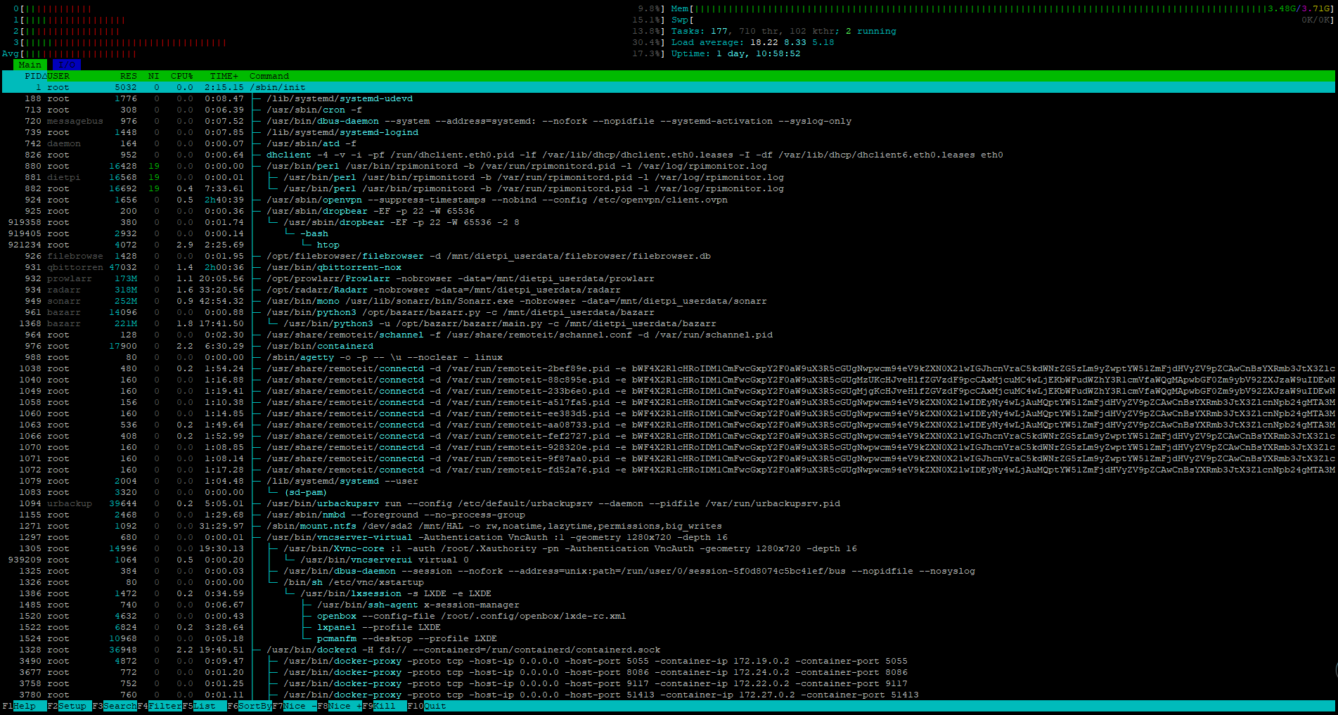

Let me share another piece of information. I’ve disabled some containers and run free -m
As a result I got:
root@DietPi:~# free -m
               total        used        free      shared  buff/cache   available
Mem:            3794        1919         296          18        1608        1875
Swap:              0           0           0
My question is then, is the buff memory oversused? If so, is there a way to purge it?
