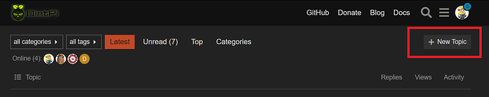

There should be a huge button on the top of the forum where , you can open new topics. Please do so and share all relevant information and logs.
thank Joulinar,
is on the mainpage, didn’t see it with all the posts.
