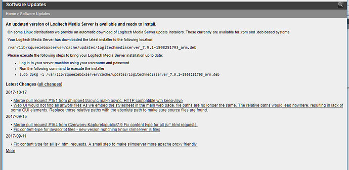

Can you wget download and then use dpkg -i logitechmediaserver_7.9.1~1505480690_arm.deb to install over the older version?
wget http://downloads.slimdevices.com/nightly/7.9/sc/d424bbe/logitechmediaserver_7.9.1~1505480690_arm.deb
sudo dpkg -i logitechmediaserver_7.9.1~1505480690_arm.deb

Hey Warhawk, thanks for your reply. I just tried out your suggested commands (Odroid C2 / Dietpi 1.56), now LMS is dead. Download & installation went okay but LMS isn´t starting any more - I´ve rebooted several times to make sure?
Your question about “apt-get” I cannot really answer since I do not understand what you´re asking for actually, I am sorry.
Might have to use the dietpi-software to uninstall and re-install…
some of the apt-get stuff and or side install doesn’t work with the scripting (from what I understand)
due to the dietpi-software running scripts once it installs to make sure it’s up and running…sorry for leading you astray and crashing your service
Please don´t worry I got the old version up and running again quite easily. But what happened basically justifies the existence of this thread, don´t you think? Right now it´s just not that easy to update LMS - at least not on the Odroid C2. Not sure if the same goes for other SBCs, too?

Try this (I see that the instructions are indeed not working):
mkdir -p /sources
cd /sources
wget http://downloads.slimdevices.com/nightly/7.9/sc/ffc273f/logitechmediaserver_7.9.1~1508904967_arm.deb
dpkg -i logitechmediaserver_7.9.1~1508904967_arm.deb
Hi, your new instruction set is basically working now but LMS won´t start (restarts every 5 sec) correctly after installation. I think I will continue over here → http://forums.slimdevices.com/showthread.php?108166-Building-LMS-for-64-bit-Debian-running-on-ARM-Single-Board-Computers&highlight=%2Bodroid+%2Bc2 ! Cheers, Ol
