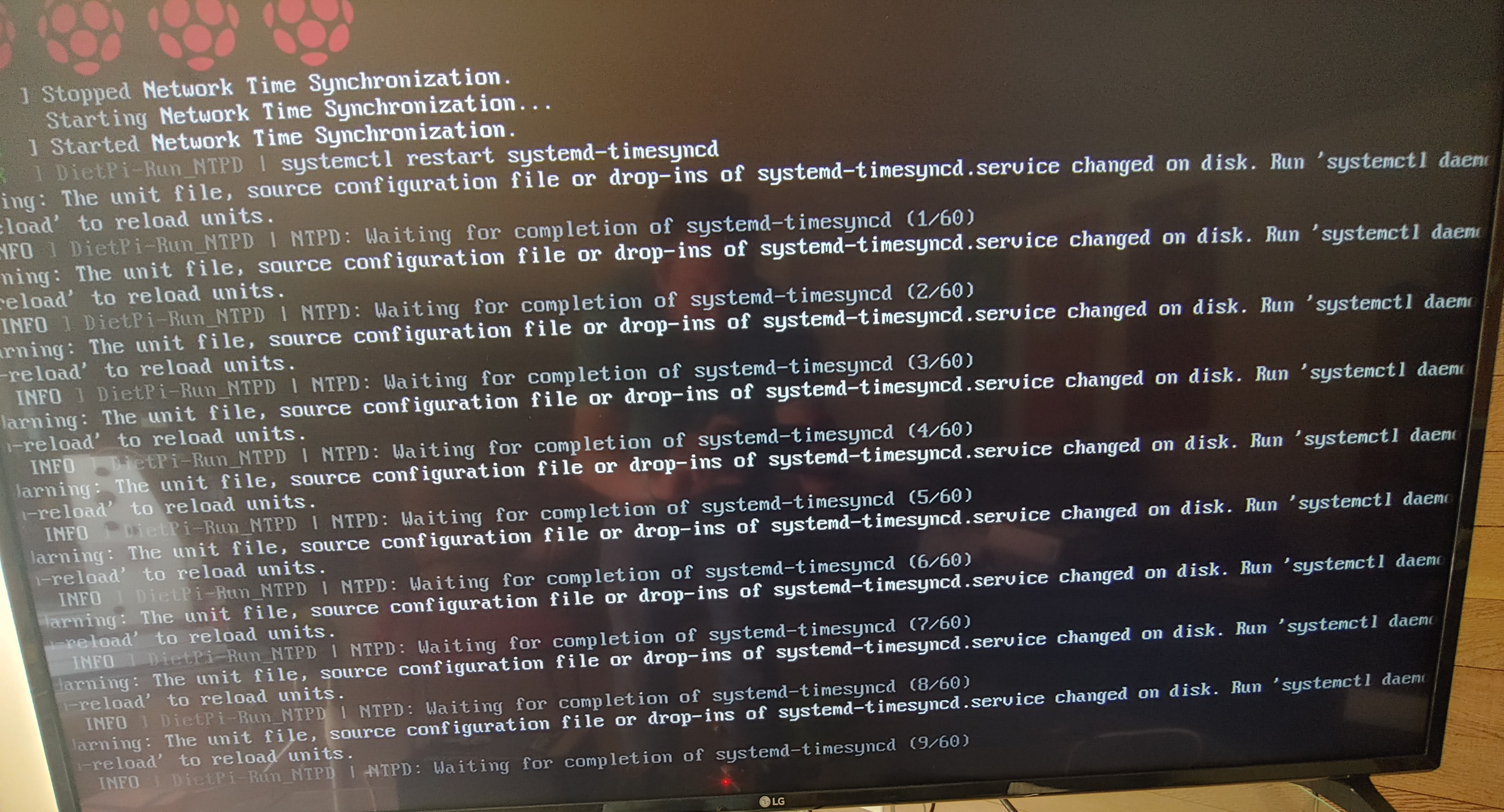

CLock not working
After I change the dietpi-config /advance/time sync mode / boot + daily.
After reboot I get these error messages on boot screen
attached the boot screen. It will go until 60 tries are made then does finally boot, and has correct time.
What do I do to fix this?

many thanks for your message. As indicated by the error message, pls do:
systemctl daemon-reload
/boot/dietpi/func/run_ntpd 1

Same thing nothing changed.
did you still have the error message about the changed drop in file? Pls do following and post the output.

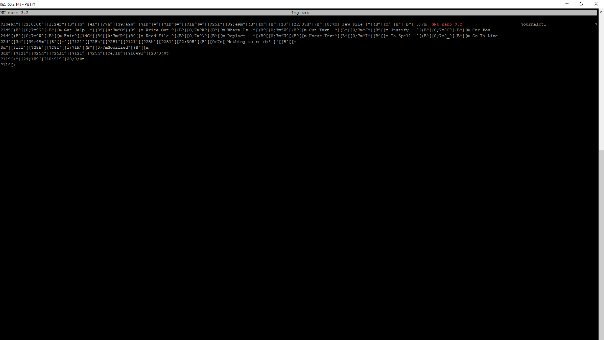

Is this what you want?
It does not look right.
As you can tell I am very new.
I sent you a PM asking if you need to teamviewer into my computer and then SSH into the PI
to get this I did the following:
Cd /tmp
nano log.txt
that looks strange. Probably something goes wrong on exporting the the journal. Usually journalctl should give you the complete boot log.

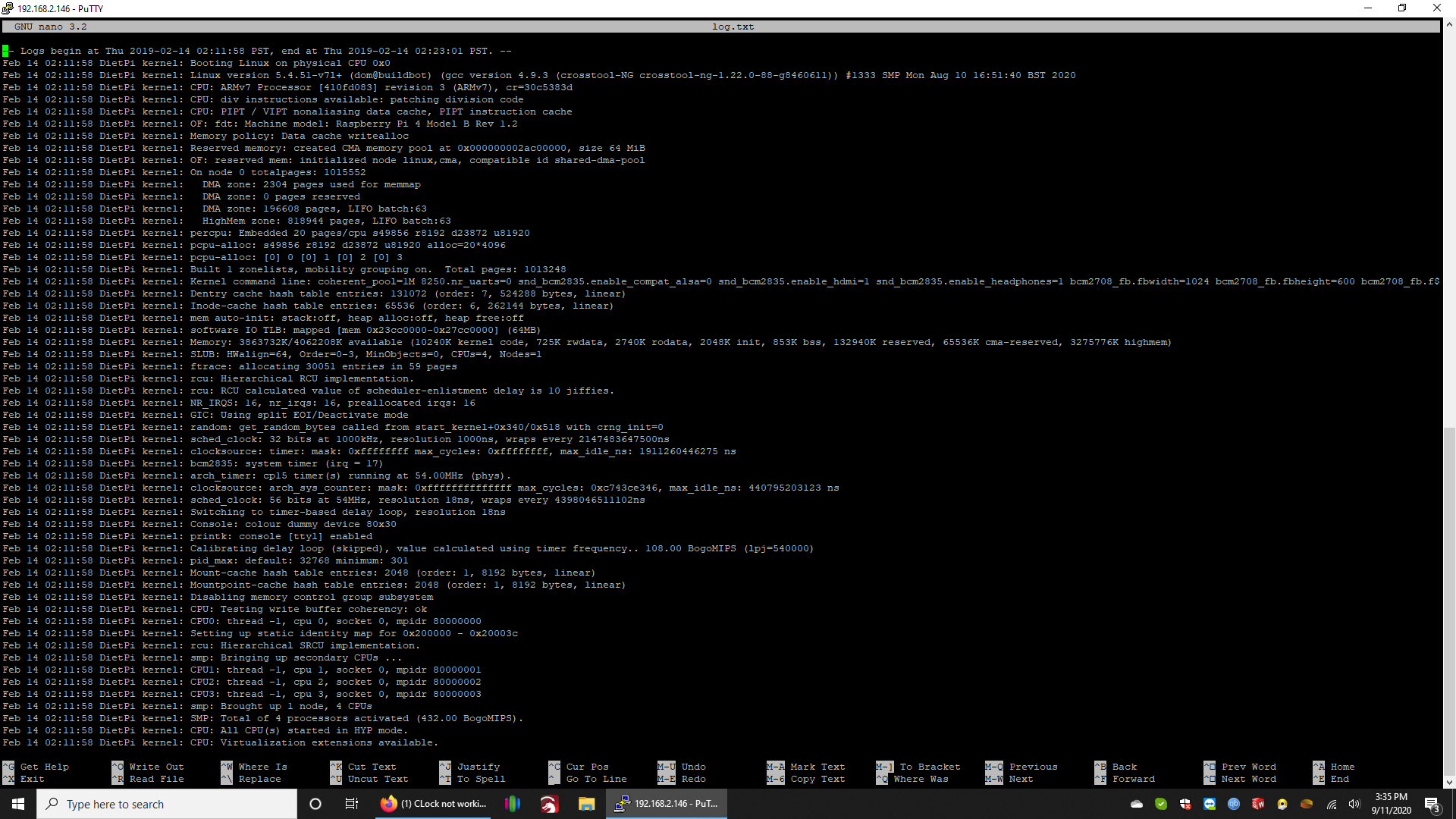

Here is another log file. Since I posted that last one, I have learned a little bit more on how to do what you asked.
this time I ran the command you listed:
journalctl > /tmp/log.txt
and then went to the dir /tmp
then I did:
nano /tmp/log.txt
this is what is looks like. Please help me get what you need.
Aim is to download entire file and attach it to this post. The output is quite long and will not fit on one screen
Got it. I took me some thinking but here. WOW. see how new I am.
log.txt (60 KB)
well your log seems pretty fine.
