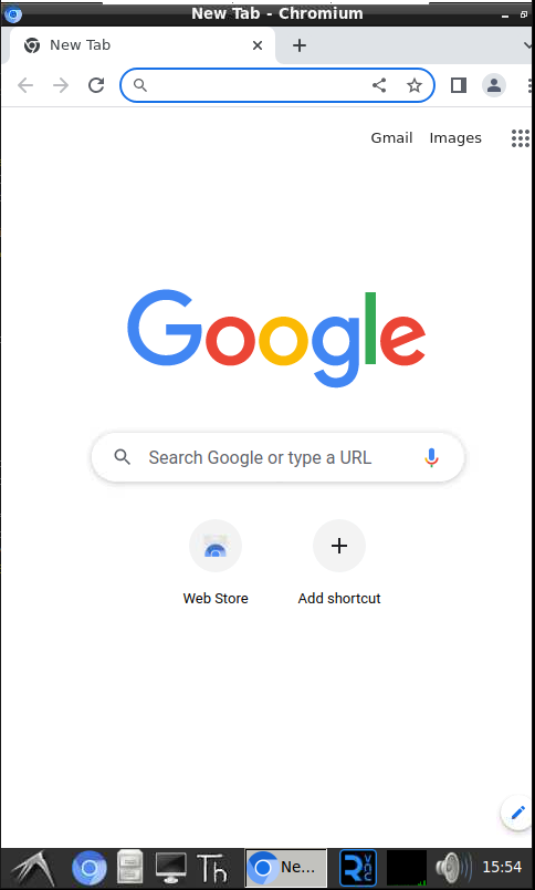

Chromium bad window size
  • DietPi version | 8
  • Distro version | bullseye
  • Kernel version | Linux DietPi 6.1.21-v8+ #1642 SMP PREEMPT Mon Apr 3 17:24:16 BST 2023 aarch64 GNU/Linux
  • Architecture | arm64
  • SBC model | RPi4
  • Power supply used | 5V 3A
  • Software title | Chromium
  • Was the software title installed freshly or updated/migrated? Freshly
  • Can this issue be replicated on a fresh installation of DietPi? Yes
  1. Install Chromium
  2. Open Chromium
  3. Maximize it
  • Fitted maximized window.
  • The maximized window is cropped at the right side, and it’s not only the bar, the webpages are also cropped, as if the actual window was bigger.
  • I’m using the official raspberry 7" touchscreen display which is rotated vertically (display_lcd_rotate=1) so the resolution is 480x800.
    This also happens in kiosk mode.
within kiosk mode, you can try to lower values within dietpi.txt below 480.
