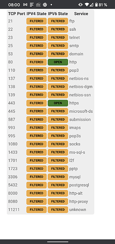

I verified that my domain “example.com” is working. Only my nextcloud instand under example.com/nextcloud does not work.
I am sorry but I am lost. I tried everything I found online and nothing worked.
All checks looked fine. But I can not access my Nextcloud over my AAAA Hostname from NOIP.com. I don’t want so switch to an other service with cost me some money for 10% of my capacity.
