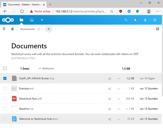

honestly I’m not sure that this is related to redis. I did a test with lighttpd as web server, and I was able to upload a file of 1.2GB without issues. I guess it’s more related to nginx as web server an some time out parameter
