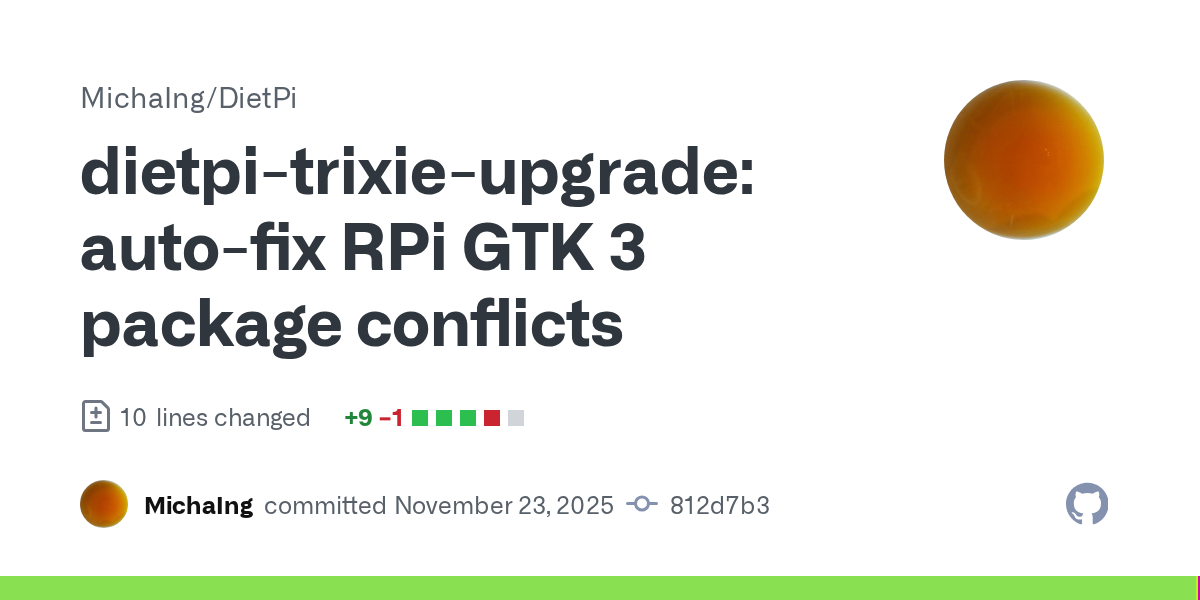

I just implemented an auto-fix for these RPi GTK 3 package conflicts:
