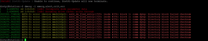

bad message while trying to stat a man page file. Can you check:
dmesg -l emerg,alert,crit,err
Here the results
there are some file system errors/corruption. can you try following
> /forcefsck
reboot
# then after reboot
journalctl -t systemd-fsck
