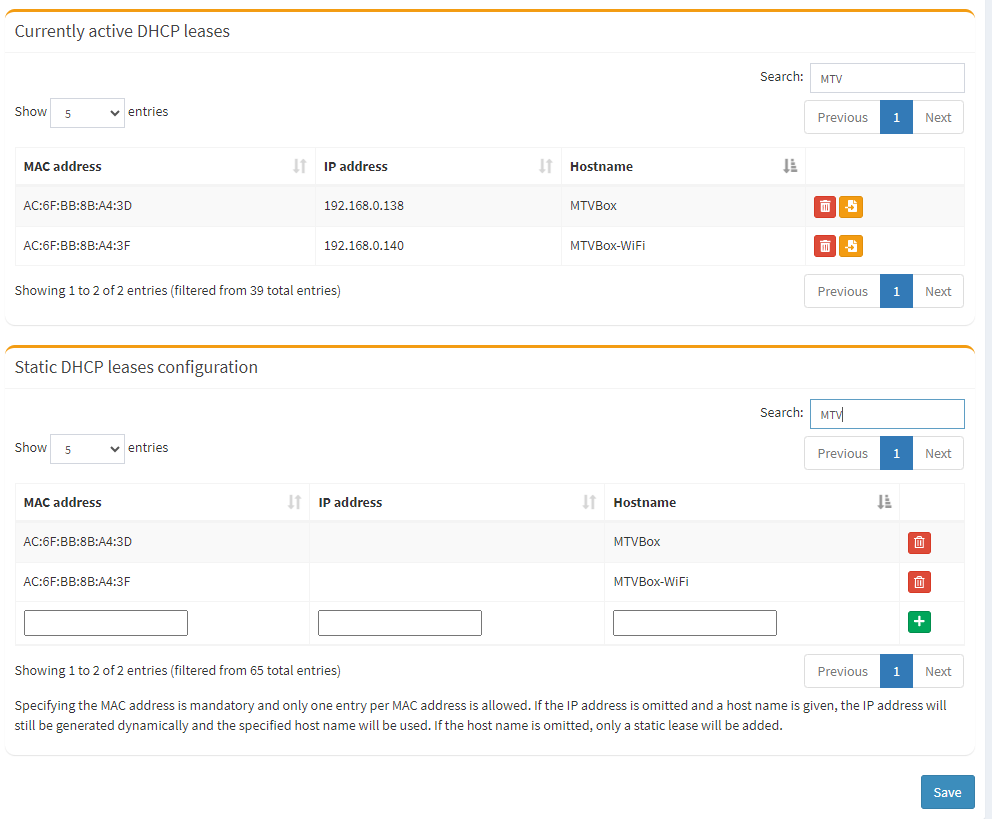

Yes, this is working without issue using Static DHCP leases configuration in PiHole. You can speficy a name only, without an IP address
For a TVBox, I have specified the name related to a MAC address.
From DHCP server TVBox is getting an IP addresse assigned 192.168.0.138 and I can resolve it from my Windows box without issue.
nslookup mtvbox.lan
Server:  pi.hole
Address:  192.168.0.11
Address:  192.168.0.138
