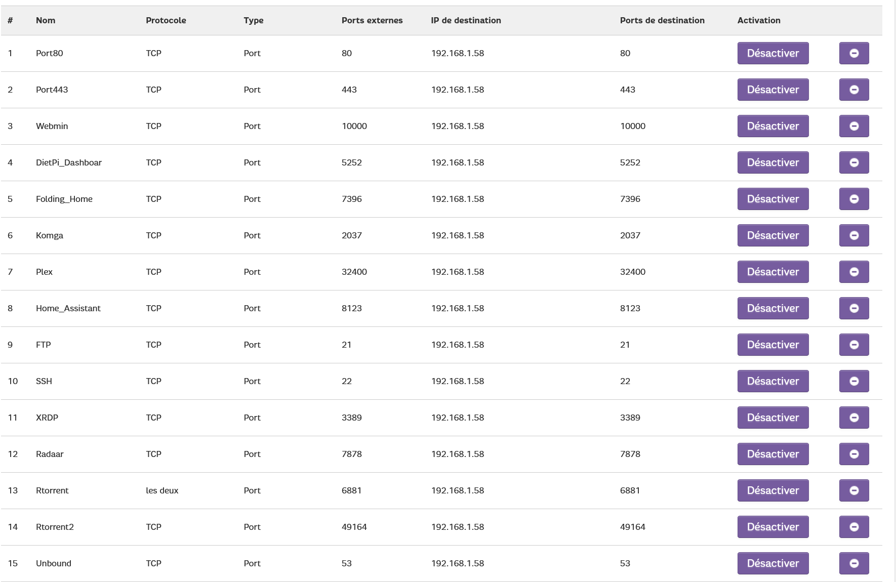

On my router, I have activate the dmz to be sure that is not port forwarding problem, but nothing happens.

Plz deactivate the DMZ, it’s not necessary and can be quite dangerous if you don’t know what you are doing.

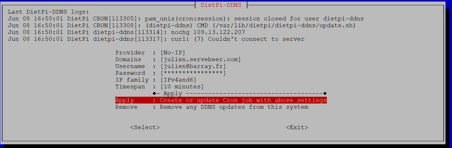

When I try to use No-IP :
Before applying settings :
[ INFO ] DietPi-DDNS | Preparing unprivileged DietPi-DDNS UNIX group ...
[ OK ] DietPi-DDNS | groupmod -p ! dietpi-ddns
[ INFO ] DietPi-DDNS | Preparing unprivileged DietPi-DDNS UNIX user ...
[ OK ] DietPi-DDNS | usermod -g dietpi-ddns -G -d /nonexistent -s /usr/sbin/nologin -p ! dietpi-ddns
[ INFO ] DietPi-DDNS | Testing DDNS update ...
[FAILED] DietPi-DDNS | DDNS update test failed, please check your input: curl: (7) Failed to connect to dynupdate.noip.com port 443 after 2090 ms: Couldn't connect to server

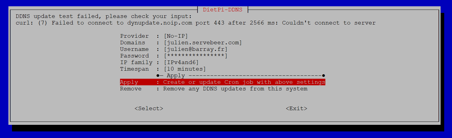

And the result :

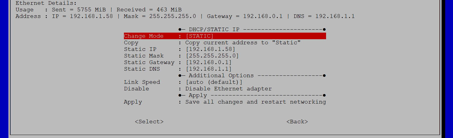

Here’s Static IP config in dietpi-config :

On STATIC, the gateway doesn’t seems to be correct. It’s 192.168.0.1 but I guess it would need to be 192.168.1.1
Joulinar:
pas
Yes it’s works.
Thank you very much.
You have good eyes, I didn’t saw it.
