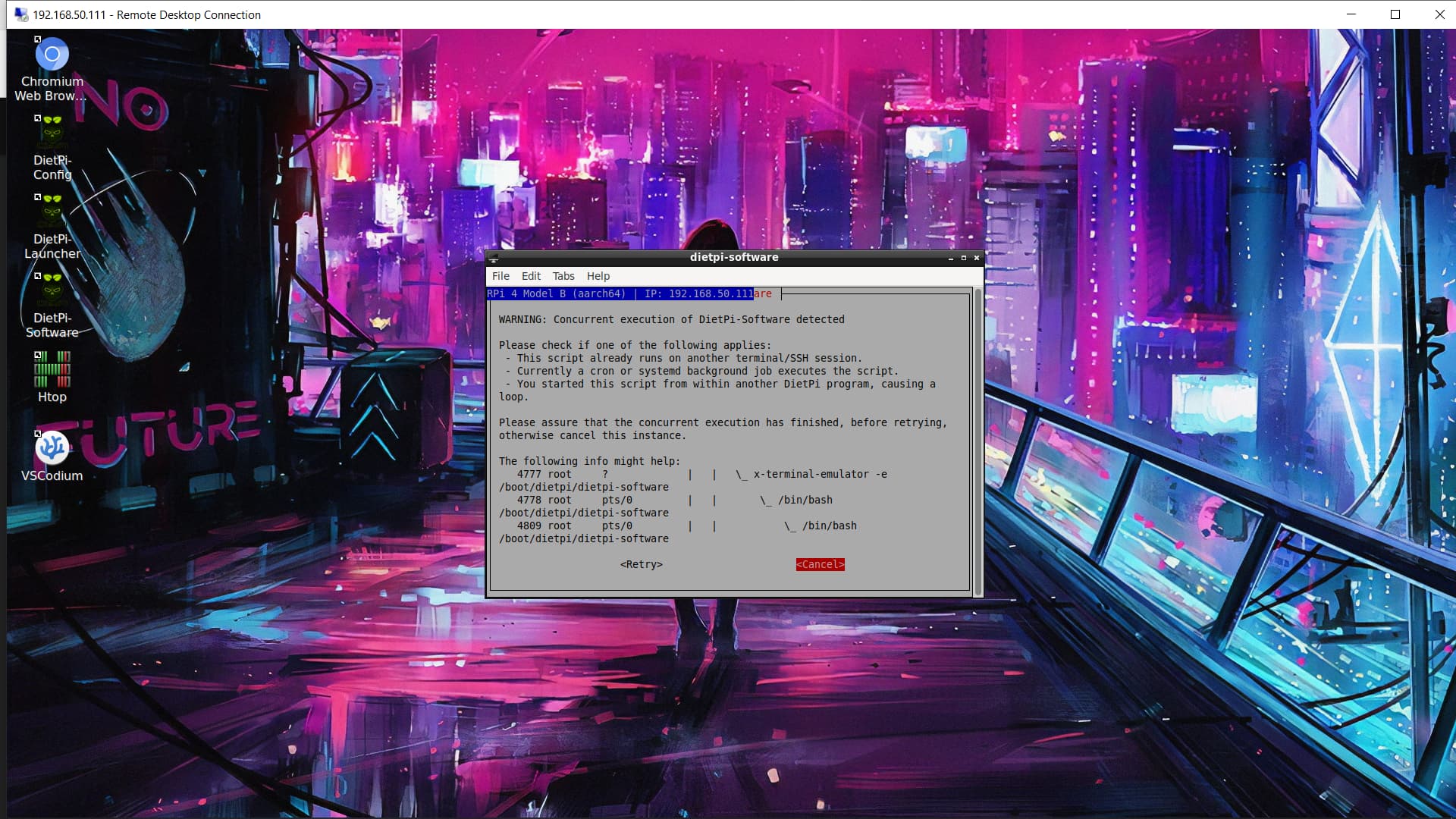

Hi folks,
When I try to launch the config (while logged in headless via XRDP), it tells me that another process is using it, and when I hit retry the PID of interfering process is changing every moment no matter how fast I retry, so it’s hard to figure out who is calling it. I tried greping the PID from all the logs I could think of, but didn’t find anything.
Any advice on how can I troubleshoot it?
Thank you
│ WARNING: Concurrent execution of DietPi-Config detected                      │
│ Please check if one of the following applies:                                │
│  - This script already runs on another terminal/SSH session.                 │
│  - Currently a cron or systemd background job executes the script.           │
│  - You started this script from within another DietPi program, causing a     │
│ loop.                                                                        │
│ Please assure that the concurrent execution has finished, before retrying,   │
│ otherwise cancel this instance.                                              │
│ The following info might help:                                               │
│   62355 root     pts/1         |   |       \_ /bin/bash                      │
│ /boot/dietpi/dietpi-config                                                   │
│   62724 root     pts/1         |   |           \_ /bin/bash                  │
│                     <Retry>                      <Cancel>                    │

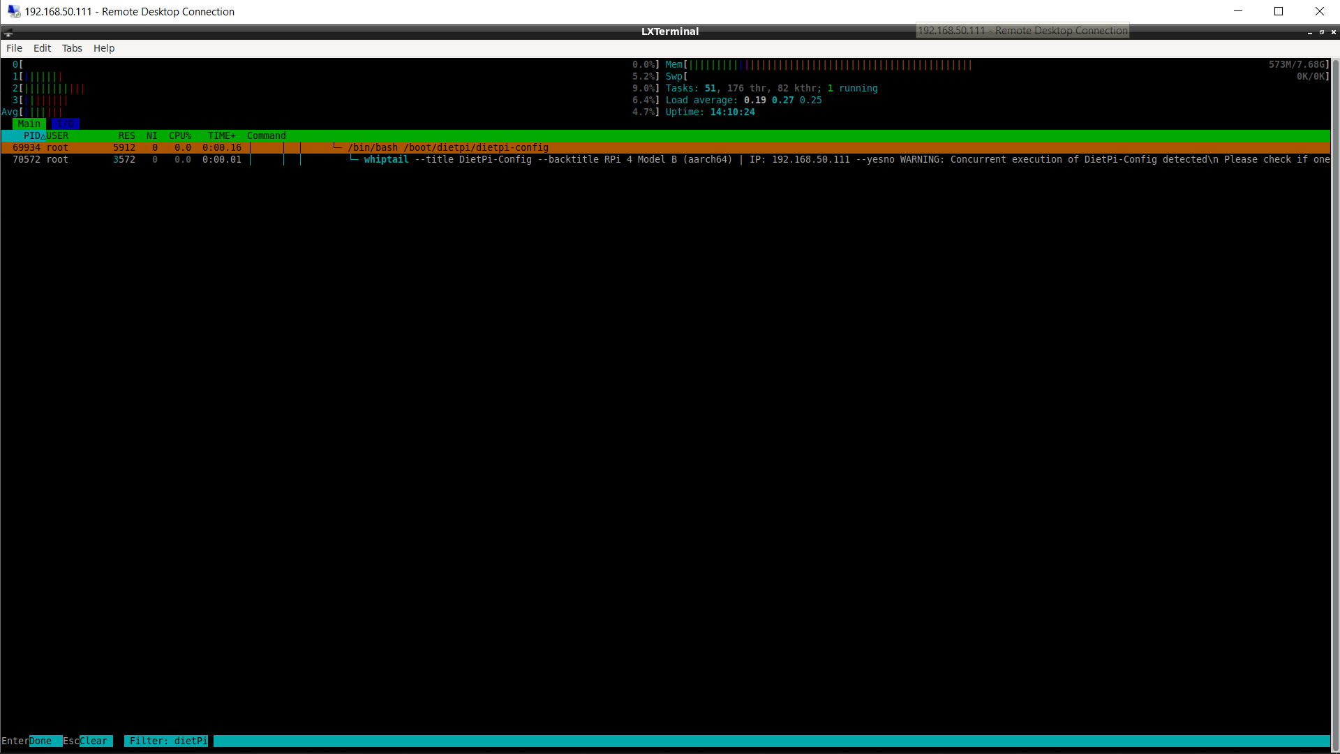

Try to connect via SSH and run htop to check what is going on.

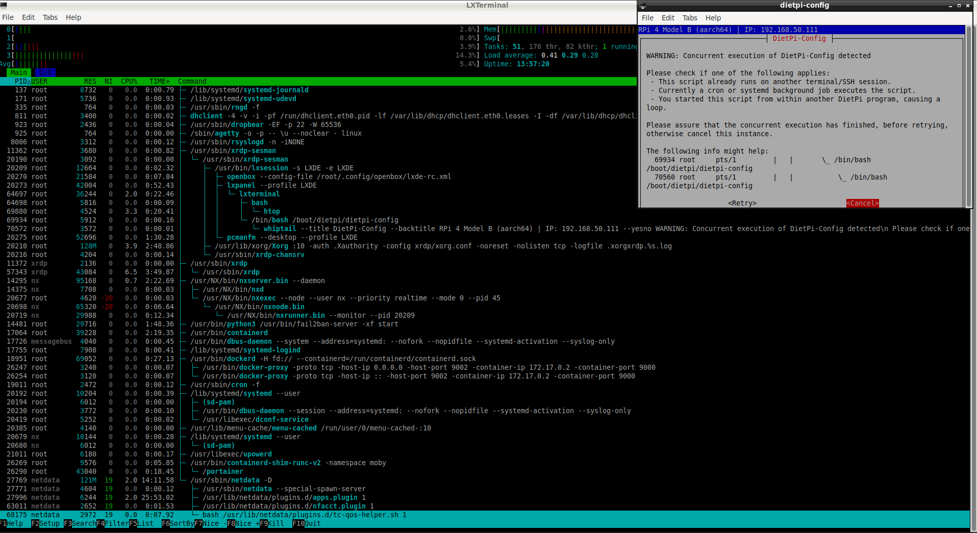

this is weird, because the only PID in the 70000s is whiptail, and if I understand correctly it is the dialog that asks me to retry or cancel diet config attempt.
filtered out - still the same:
Probably a zombie process. Reboot should fix it

The concurrency check does not really check for a concurrent process (which is a very slow check) but whether the related working directory is already present, /tmp/DietPi-Config, respectively /tmp/DietPi-Software. Those are created when starting the script, as working directory, and removed when exiting the script.
Your htop indicates that the script instances which created the directories are indeed not running anymore. So they must have been hard killed (no simple SIGINT or SIGTERM or regular exit, but SIGKILL) to not leave a chance to remove the directories via EXIT trap.
Do you exit all scripts before closing the RDP session? Probably XRDP kills the current session and all child processes hard via SIGKILL when just closing the RDP client :thinking:.
