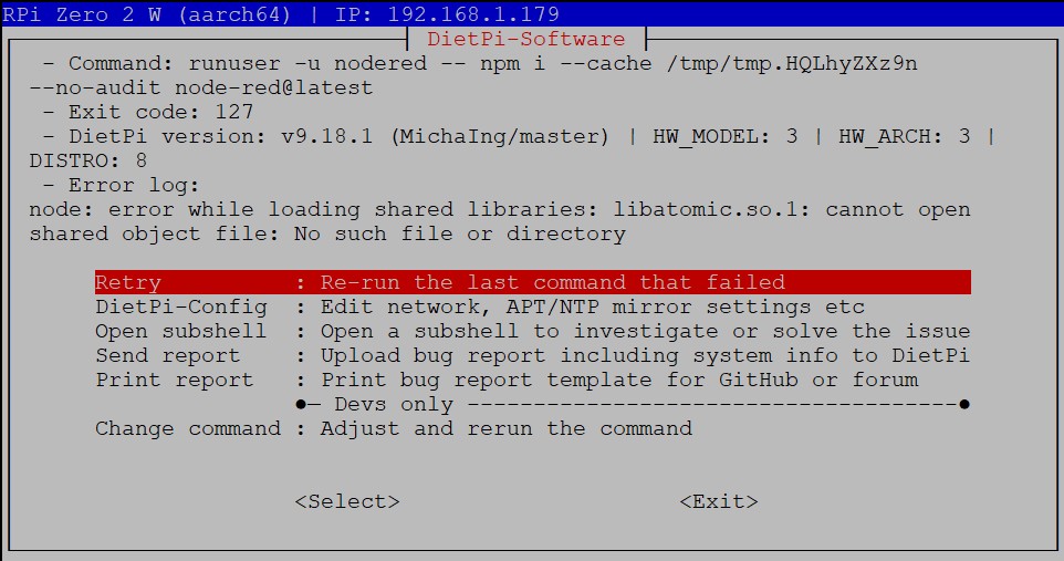

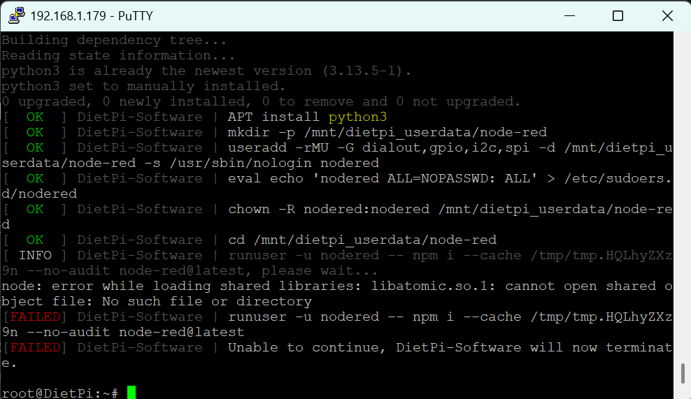

I’m trying to install Node-red on three of Dietpi’s distributions. What’s going on? Please help. @MichaIng
pls do apt install libatomic1 and try again.
