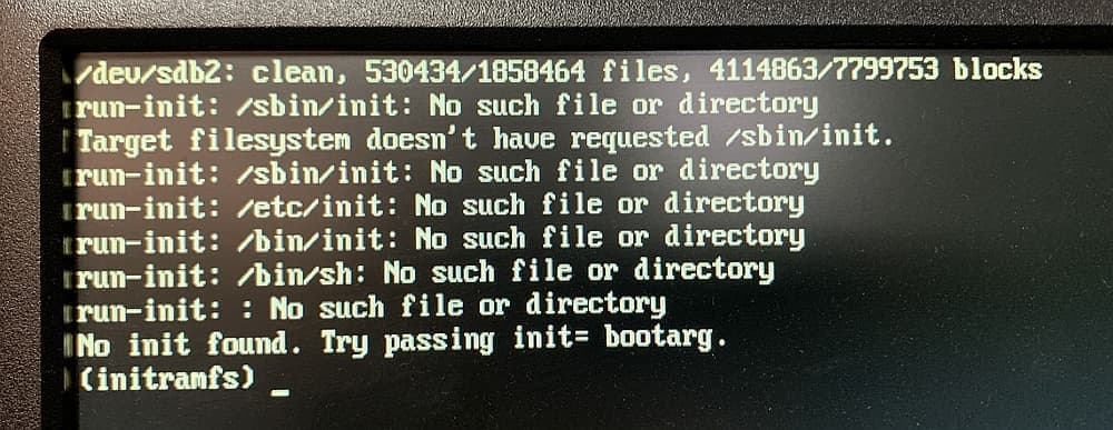

A month ago I messed up the installation by running a restore - from what turns out to be a corrupted backup - and the system would not boot. As a remedy, I swapped in a larger OS drive and loaded a fresh DietPi (v9.5.1). Prev OS drive is connected as source for old backups. Then, attempted to restore from remaining two un-corrupted backups.
The restore ran smoothly, but upon reboot the system hung, displaying this on the console screen:
I repeated the above steps, using the other full backup… with the exact same bad result. No choice but to rebuild from scratch (ie: following recipe as before).
