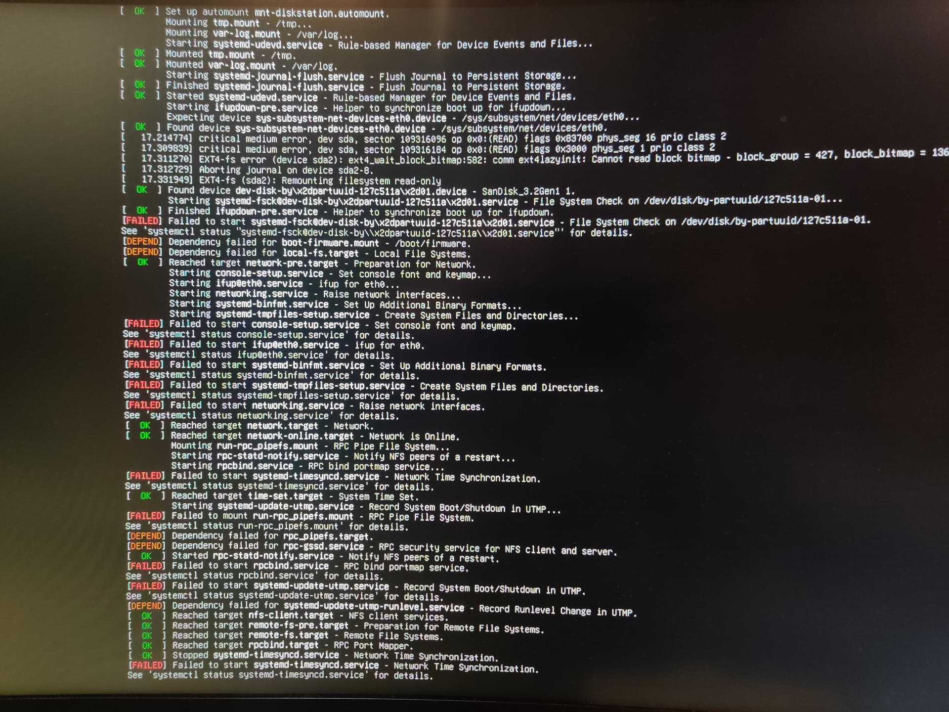

first step, get a screen and keyboard connected to check if the system is booting fine.
Good idea…
I tried this and it didn’t look good, screenshot attached

try to boot your RPi4 from SD card and connect your external drive afterwards. This way you could do some more checks on the corrupted file system.

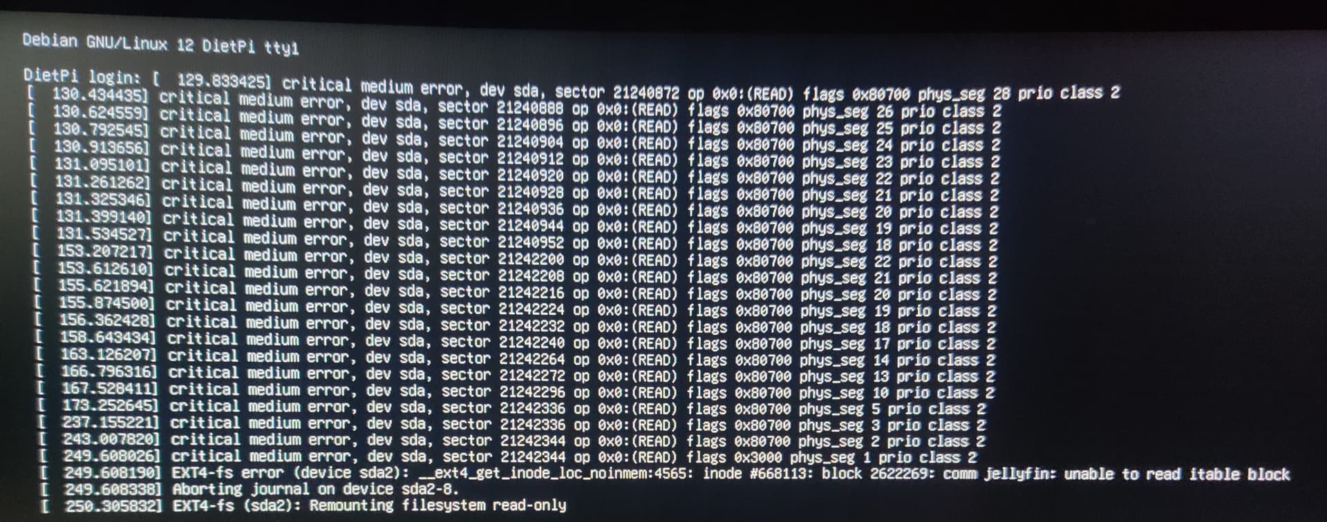

Plugging the drive back into the R-Pi did boot and showed the login prompt, but each time I tried to login it ejected me back to the login, eventually I saw the following lines…
yes your drive is going into R/O mode. This indicated quite some damage on that drive.
Yes, looks like it, I did this to my old SD cards on the same machine, it happens when I have power outages…

Your drive is effectively dead. Replace it. The built-in badblocks tool is not designed to work on flash drives or any sort of solid-state drive, it will not work the way you want it to.
