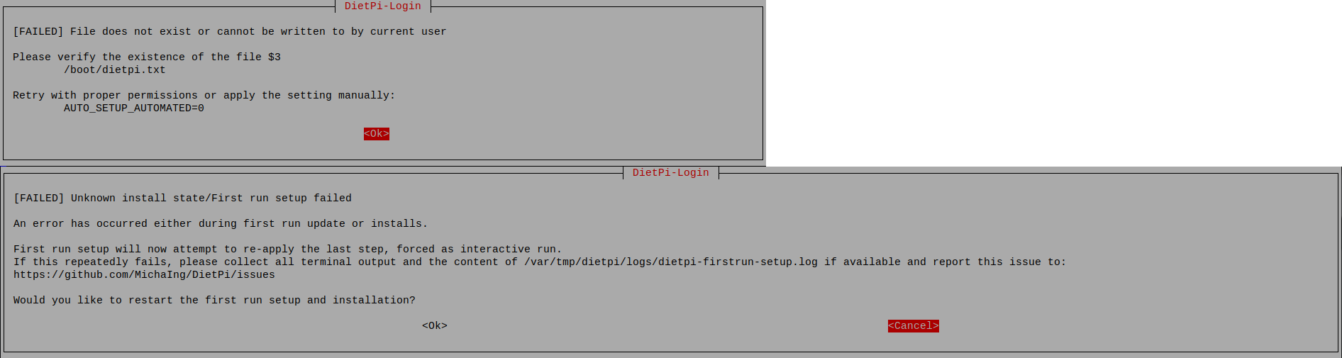

Just a few related errors which I could spot are on login via ssh:
And following the information via the DietPi login screen on terminal:
/boot/dietpi/func/dietpi-banner: Zeile 63: ((: == 20 : Syntaxfehler: Operator erwartet. (Fehlerverursachendes Zeichen ist "== 20 ").
[translation] line 63: ((: == 20 : syntax error: operator expected. (error-causing character is “== 20”).
Of course, all the commands like ‘dietpi-update’ cannot be found as they also refer to /boot.

we are aware on this change introduced with RPi5
Actually, we are working on a migration method from old to new file system layout. Until this, you need to stay with an older kernel version not depending on this change.
Alright. Thank you very much for your quick reply!
I reverted my changes, returned to FW_REV 6f1dcc758829cfd56d7c2f16513aaefa876902b2 (6.1.54-v8+) and I will wait patiently. :slight_smile:
BTW: RPI developer removed dependency between packages and workaround is not needed anymore. Package raspi-firmware is not configured yet · Issue #6747 · MichaIng/DietPi · GitHub
