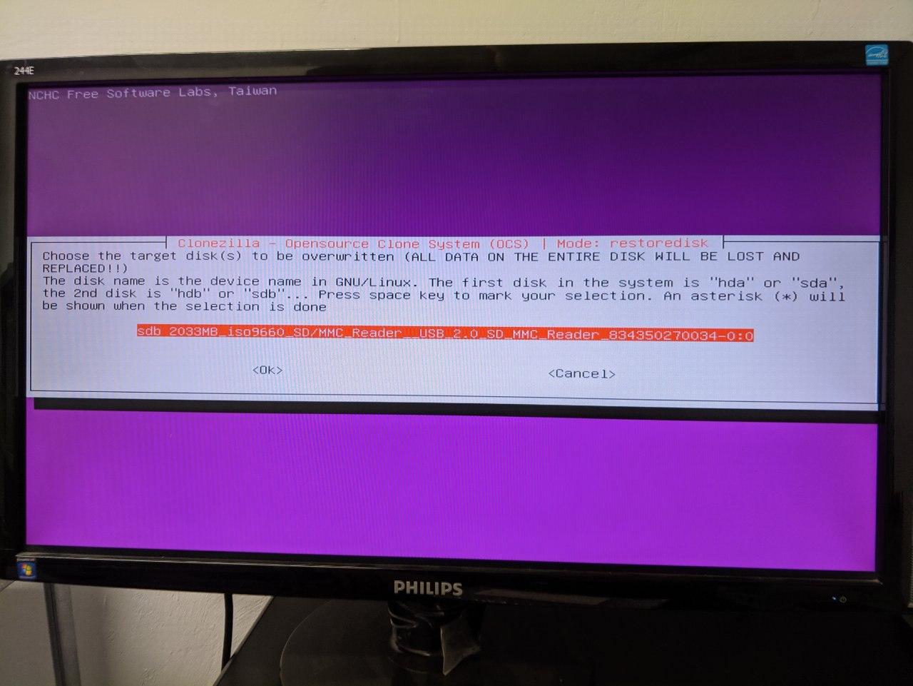

I would like to flash dietpi on the ssd directly from the beginning but the installation does not allow me, it does not see the ssd but only the memory card! I don’t understand why. Eventually I’ll try with dd… Tnx!
hi, what system you are using the flash the image to SSD?
