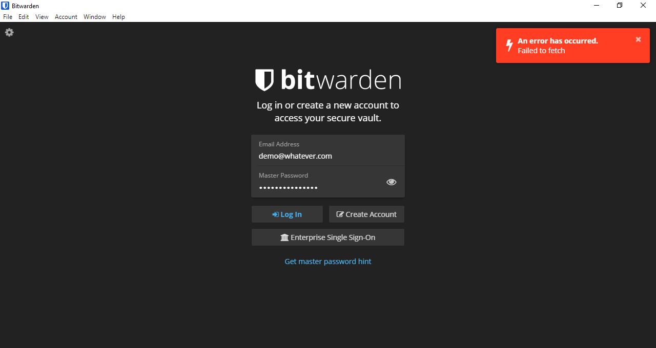

I tried everything again today! Bitwarden web server works (https://192.168.1.105:8001), Firefox Plugin and Opera Extension too! Bitwarden app in Windows 10 failed? It says failed to fetch! I tought it works yesterday… It did or I forgot to test the Windows 10 app!?!
I tried both with rpi 3 and with windows 10 vmware virtual machine and I have same error message (everything else works)?
I also tried Edge browser, no issues with the web server! Is there a place that I should copy the certificate in Windows 10 to make it work with Bitwarden app?

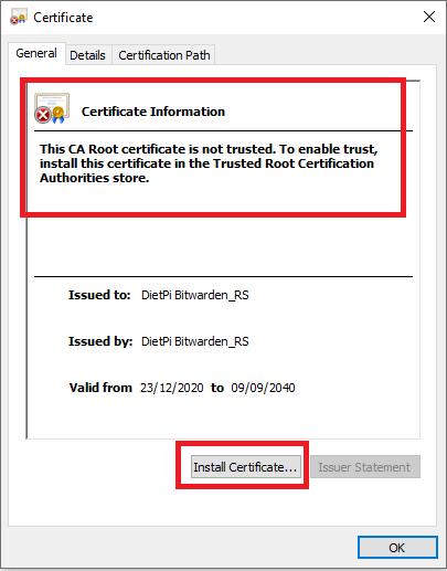

  1. close Bitwarden App on W10
  2. create the .crt file on DietPi
  3. copy the file to your W10 system
  4. double click the .crt file
  5. you should get the following
  6. click install
  7. select Trusted Root CA once ask

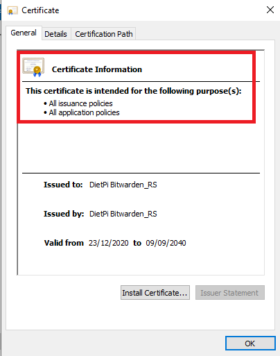

  8. once installation finished you can double click the .crt file again to verify if it was installed correctly
  9. it should be trusted now
  10. Now you can open Bitwarden App
Many thanks, however for Windows 10 we have a guide already, which is starting with downloading the certificate from within the browser when accessing the web vault. But from opening the certificate file on it matches yours: https://dietpi.com/docs/software/cloud/#bitwarden_rs

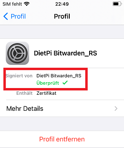

I testes a self singed certificate with a running time of 20 year without issues on my test iPhone SE running iOS 14.3.
It was accepted in profiles
with a run time until 2040
and I could activate it within Certificate Trust Settings
