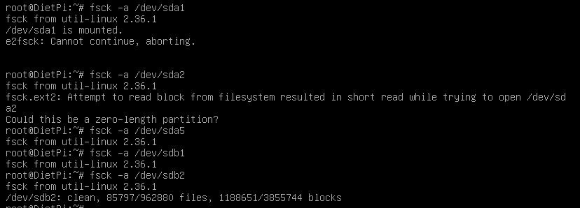

I’ve run your commands and this is what i have
you need to perform checking on a different system/installation where your disk is not mounted.
just to avoid a misunderstanding. Which of your drives has issues? I see two drives connected?
BTW: if possible try to copy information from SSH terminal directly and avoid doing screen prints.
I don’t know why it shows 2 drives, it’s a single microsd card.
Maybe sdb1 sdb2 are partitions?
I think the confusion was that you tried fsck /dev/sdaX
as well as fsck /dev/sdbX
, while the first is the rootfs of the external system where you are trying to repair the SD card, right? Try this:
