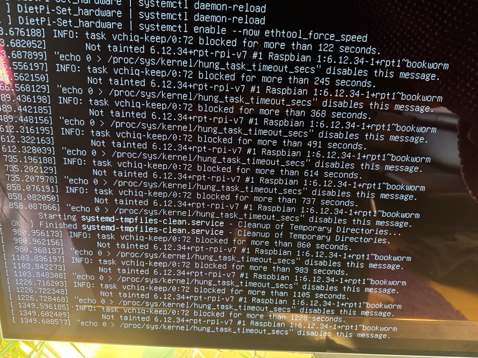

I’m running into problems when installing via dietpi.txt automatic install.
I do not have the issues without the custom automatic setup.
I am not sure at what point the PI should be reachable via ethernet, but I cannot see or ping it
Here is the output of my PI where it hangs/is stuck, and my file

The vchiq-keep hung task message is unrelated, it is actually hanging here
Or more precisely at this command it seems:
ethtool -s eth0 speed 100 duplex full autoneg off
assuming you are aiming to enforce 100 Mbit link speed. This means you set AUTO_SETUP_NET_ETH_FORCE_SPEED=100 in dietpi.txt.
Note that this is not needed in your case. The reason and only case I know about where this was needed, was a certain SBC with 1000 Mbit Ethernet, but using it was very unstable, and much better when limiting the speed to 100 Mbit instead. We should probably enhance the description in dietpi.txt and dietpi-config about this.
However, it should not hang, of course, and especially it should stop hanging at latest when the default systemd unit startup time has been reached. Looks like aiming to set the link speed like this hangs the kernel at some lower level, somehow.
Which RPi 2 revision is it? PCB v1.1 or PCB v1.2? I could try to replicate it in the first case. Since first run setup never finished, you could just edit dietpi.txt and set AUTO_SETUP_NET_ETH_FORCE_SPEED=0 again, which leads to the removal of this hanging service, in case I do not misinterpret the logs. Then above command could be tested to narrow it down.

As far as I can see, the issue has nothing to do with automatic setup, since it hangs when the dietpi-firstboot script runs, which is way before the automated setup/login happens. So did you set AUTO_SETUP_NET_ETH_FORCE_SPEED to something other than 0? Not to confuse with the custom script setting that you were talking about .
