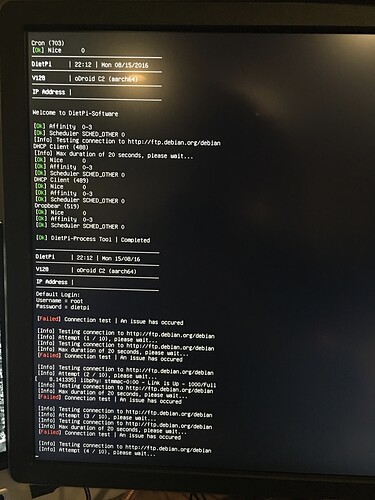

Automated installation failing on "connection test"
I’m attempting to create a headless install by enabling the Automation Options in dietpi.txt. However the install halts during “DietPi-Software” due to repeated failed “connection test” attempts.
“ifconfig” shows eth0 is up but has not obtained an IP, if I run “dhclient eth0” the interface is able to obtain an IP, at that point I can “exit” and it will continue with the rest of the install. Also, rebooting will obtain an IP and the install will finish. Any ideas what the issue might be?

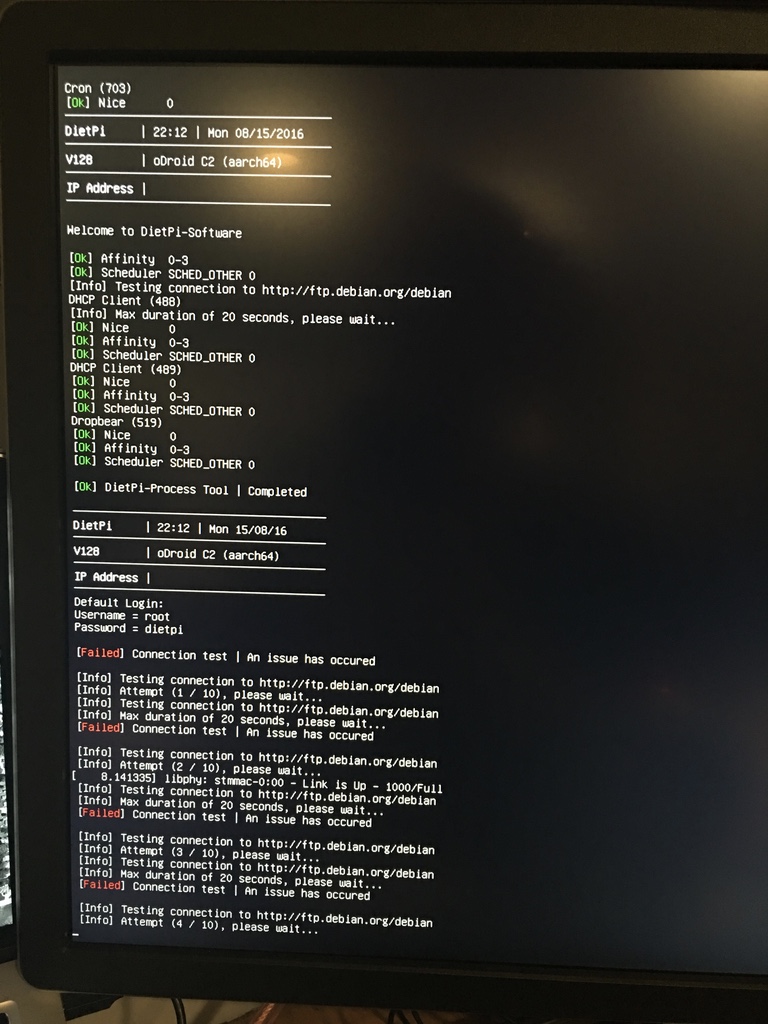

Success! I burned a new image with the modified boot file and while it did still fail the connection test 3 or 4 times it then past and continued on.
I notice the connection test says “Max duration of 20 seconds…” but it only seems to wait maybe 1-2 seconds, is this how it is supposed to perform or is that something also to do with the speed of the C2?

Thanks for the report.
Yep, it shouldn’t take 1-2 seconds, could be a bug in the code, i’ll take a look.

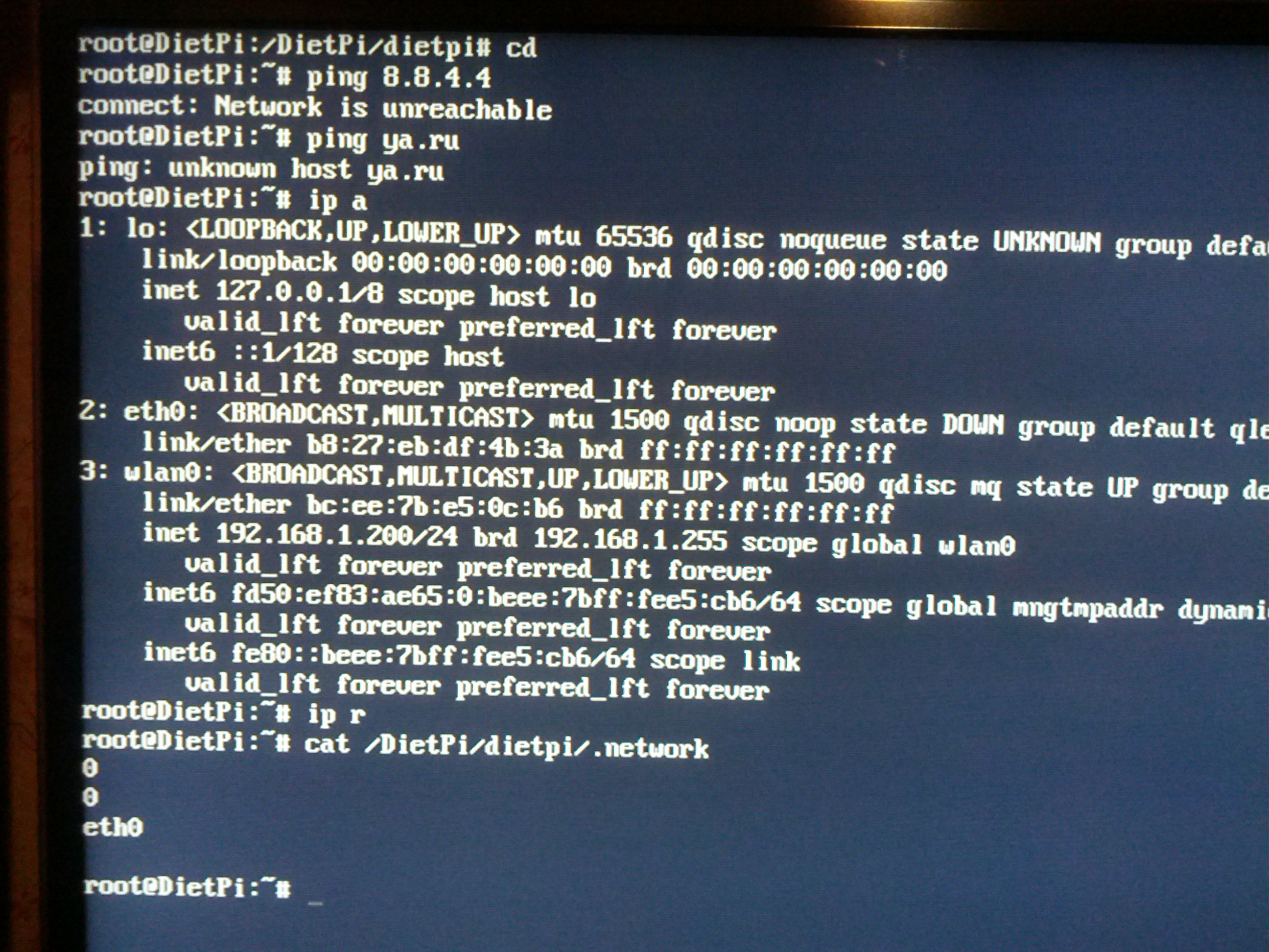

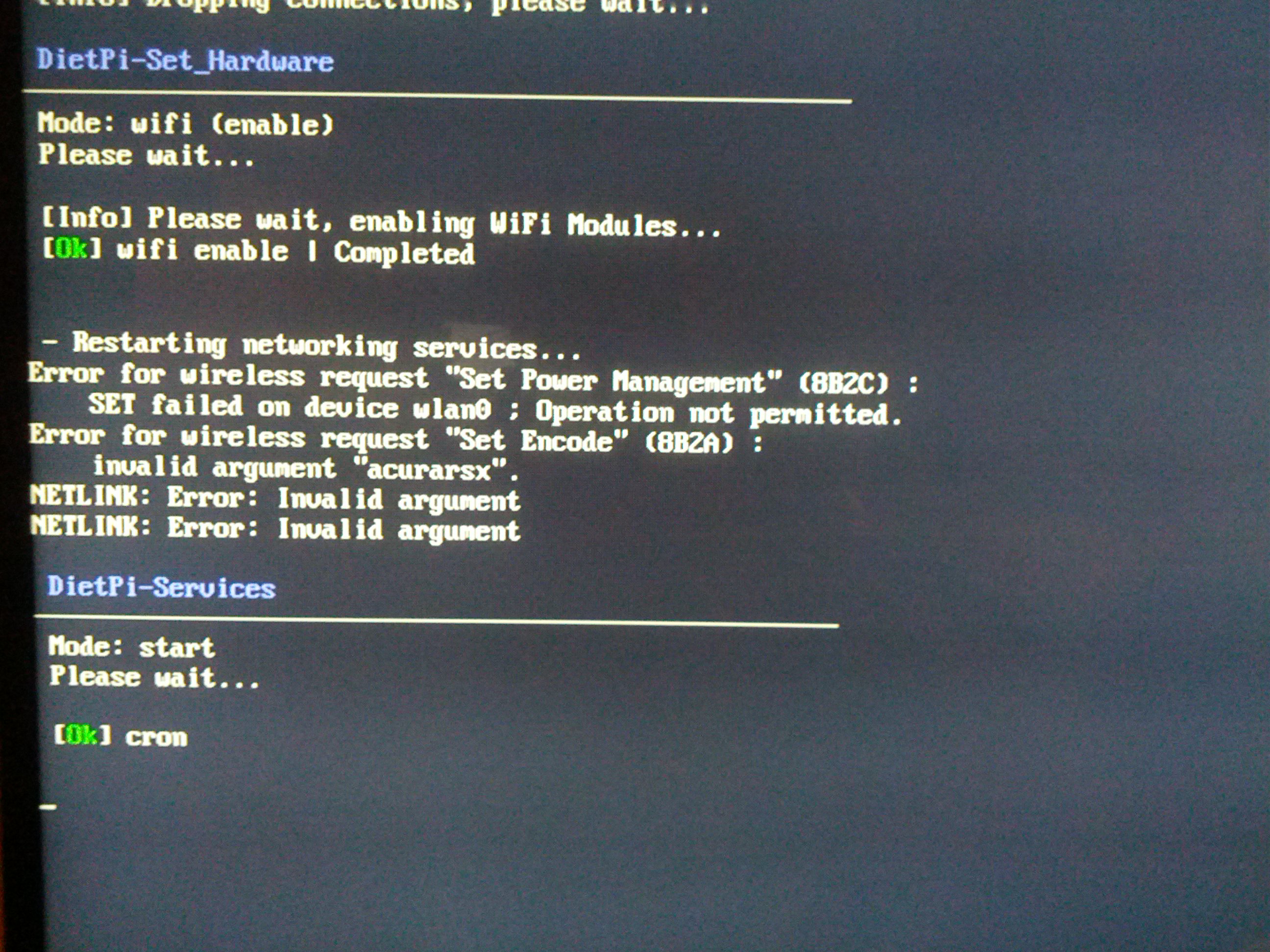

I have the same error on raspberry pi model B on first boot. Wifi adapter - asus usb n13. Dietpi v130. On previous versions all was working fine. What do i need to do?
Hey,
what is output of:
ping 8.8.4.4
ping heise.de
ip a
Ehternet disabled in dietpi.txt, but it exists in .network file, and no wlan0 string.

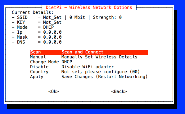

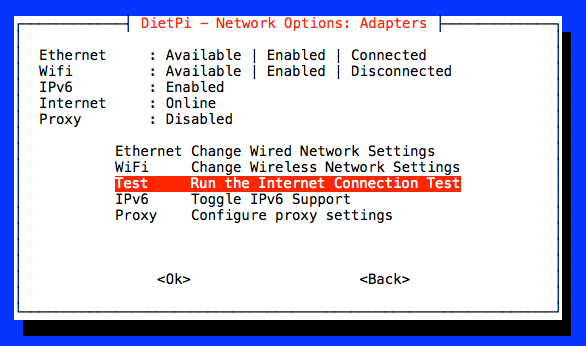

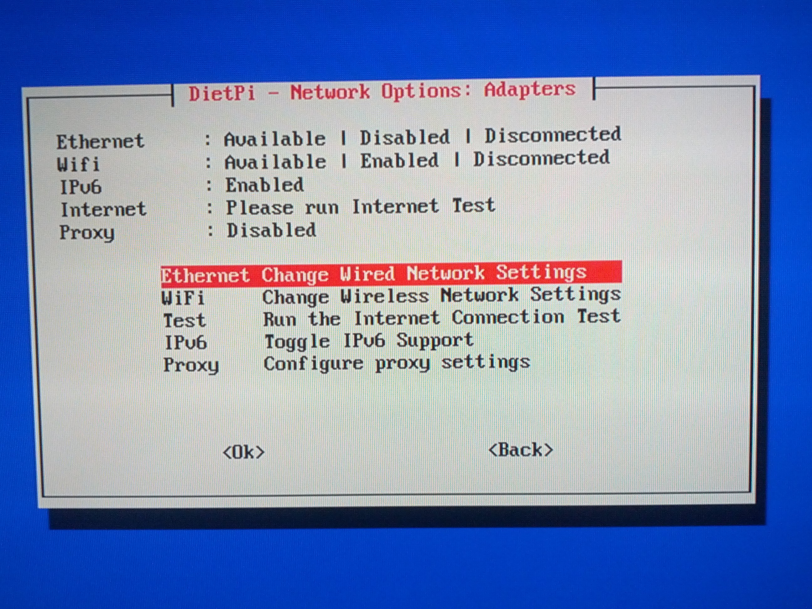

Whats did Network Options: Adapters shows in dietpi-config ?

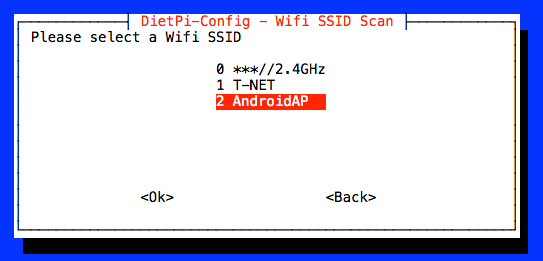

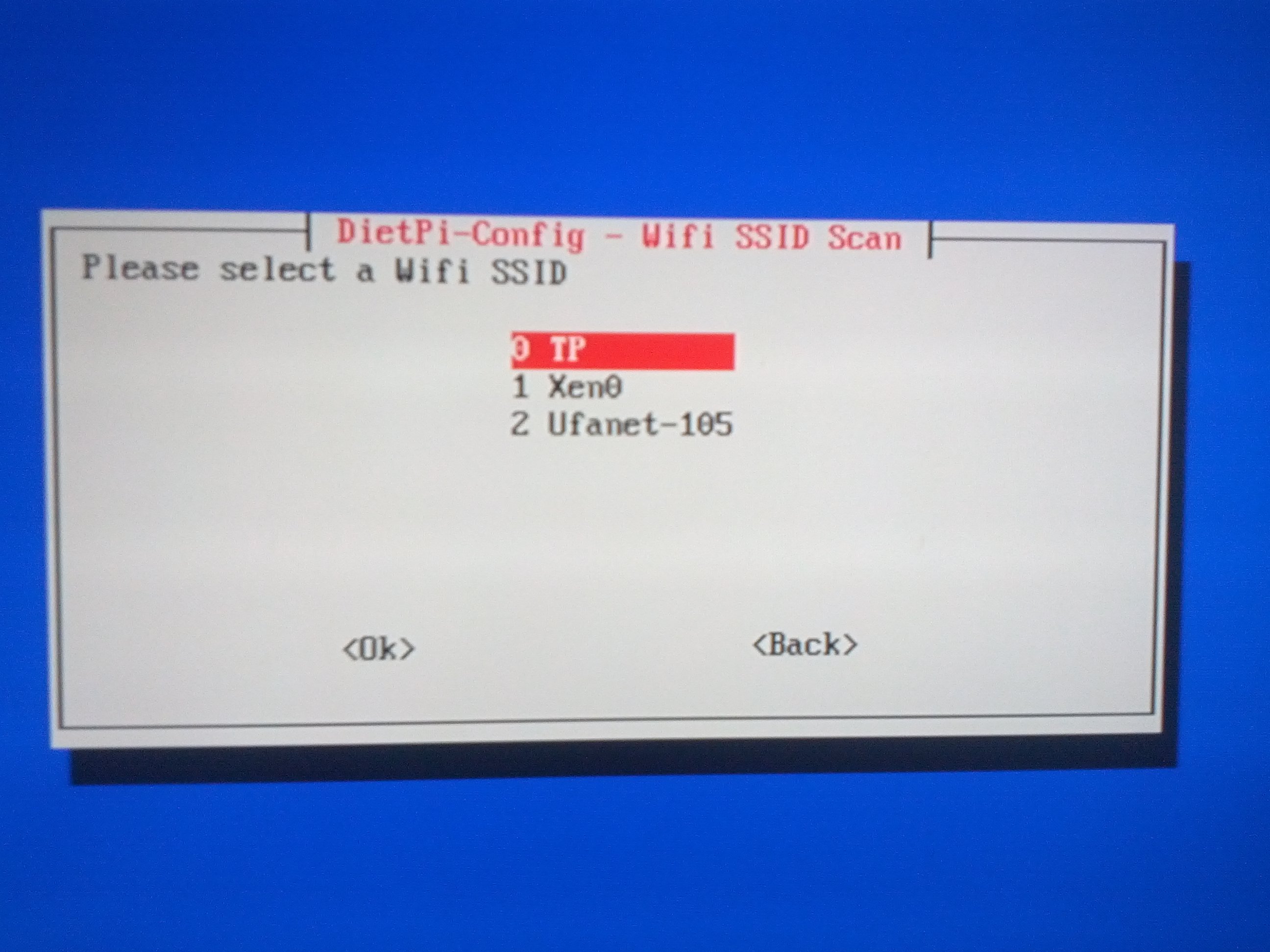

What happens, when you hit “Scan and connect

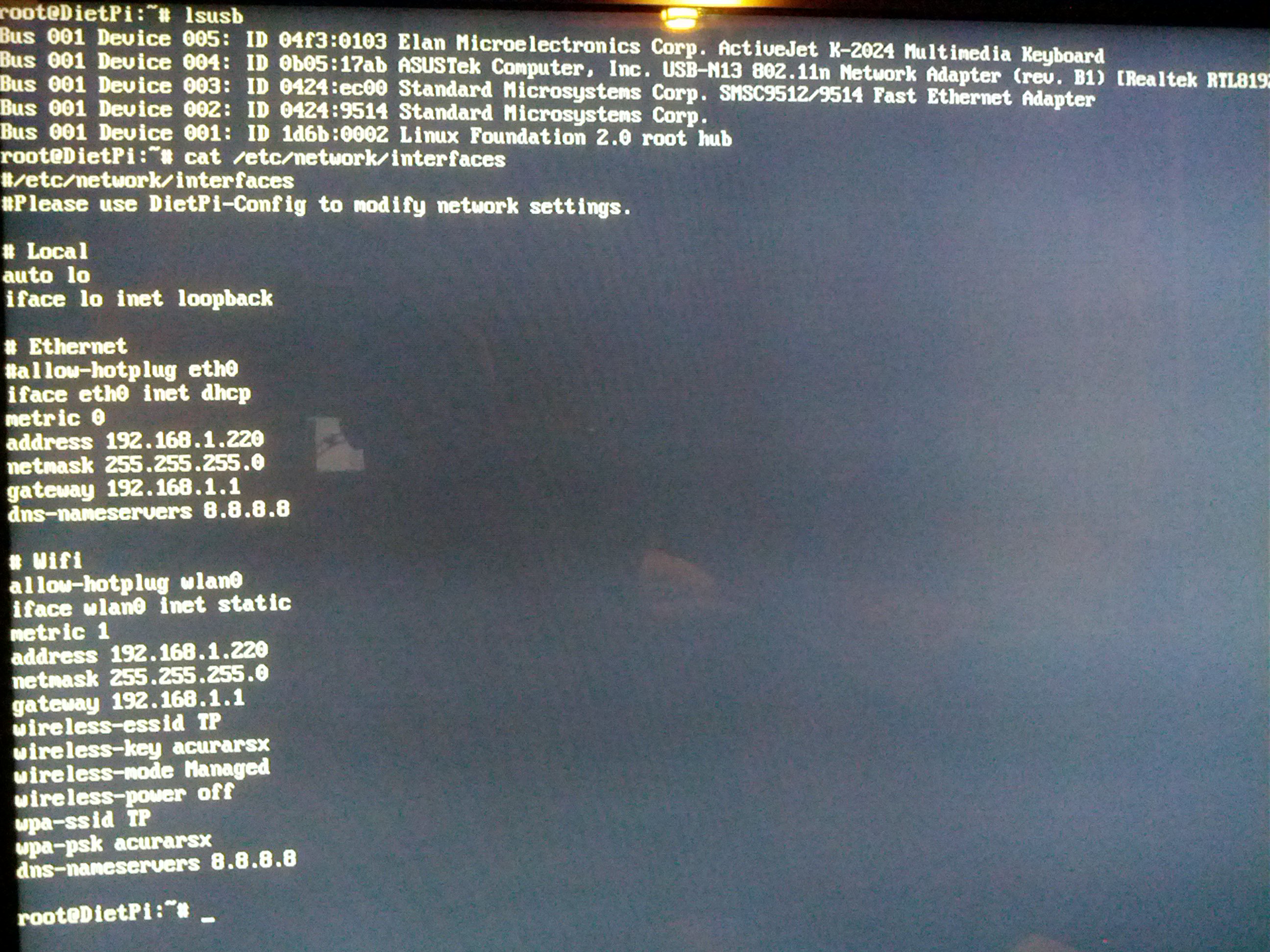

Output from:
lsusb
cat /etc/network/interfaces

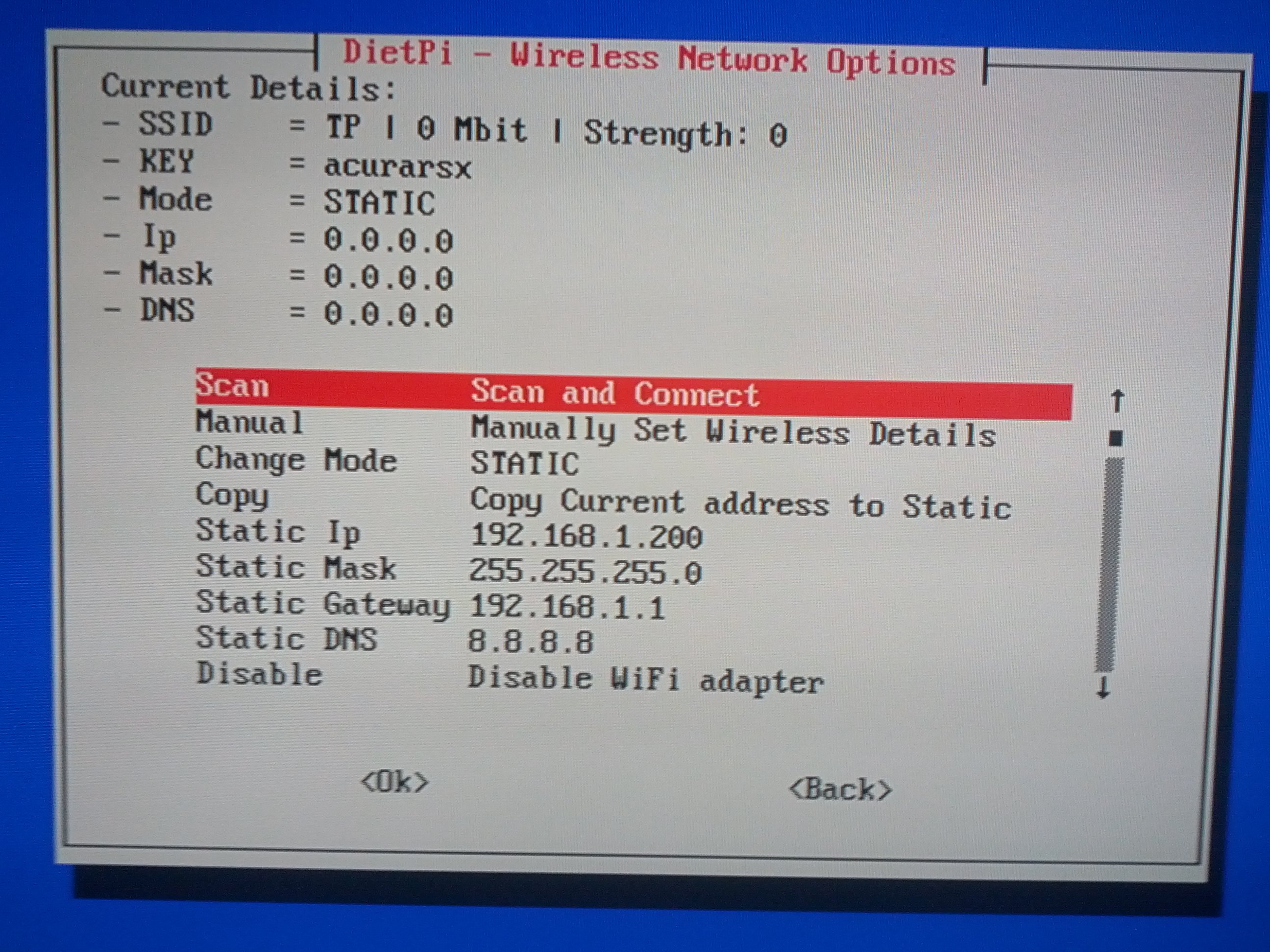

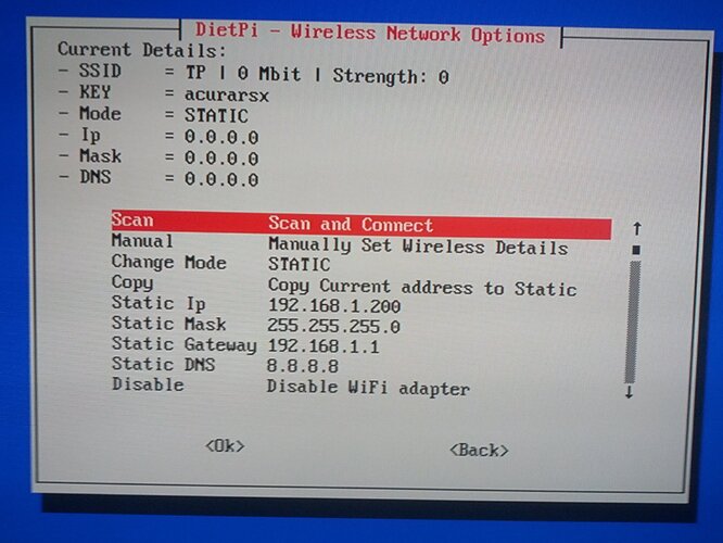

I am using DietPi_RPi-armv6-(Jessie). When i hit “Scan and connect” it find my ssid, then i enter password, and during network service restarting i get errors (NETLINK: error: invalid argument) and network is not working. If i choose DHCP then “scan and connect” and continue, i am getting IP address and other parameters, and network start working. But i need static network parameters applying during 1st boot. I think, that set WiFi country code is not necessary(am i wrong?) i tried set it up to RU and US, but it is not solve the problem. I have TP-Link 1043 nd v1 router with openwrt. WiFi working on 11 channel. but i tried others - no result. Do you have jessie v127 image? Because on v127 ALL working fine. Maybe new kernel is the problem or drivers for RTL8192?(my wifi adapter) Thanks for your help!

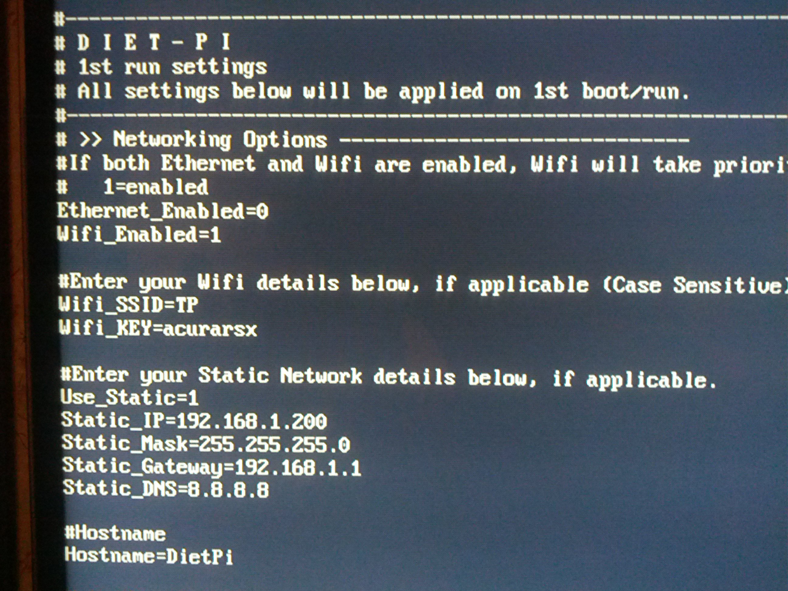

Testing with:
  • RPi B+
  • image: DietPi_v130_RPi-armv6-(Jessie).img
  • changes in dietpi.txt
Ethernet_Enabled=0
Wifi_Enabled=1
Use_Static=1
AUTO_Install_Enable=1
wifi_country_code=DE
  • wifi adapter (chipset - Realtek 8192cu ):
:~# lsusb
Bus 001 Device 005: ID 7392:7822 Edimax Technology Co., Ltd
:~# lsmod
Module                  Size  Used by
brcmfmac              201814  0
brcmutil                9031  1 brcmfmac
8192cu                597488  0
evdev                  11650  0
cfg80211              499234  2 brcmfmac,8192cu
rfkill                 21397  2 cfg80211
bcm2835_gpiomem         3823  0
bcm2835_wdt             4133  0
uio_pdrv_genirq         3718  0
uio                    10230  1 uio_pdrv_genirq
fuse                   90152  1
ipv6                  367575  14
Result:
  • booting up with static IP on wifi and disabled ethernet ==>> no IP address, no IP connection
  • switching via dietpi-config to DHCP ==>> IP address and IP connection will work

Have create a github issue for this: https://github.com/Fourdee/DietPi/issues/515
Solution at the moment:
  • only use DHCP for wifi
UPDATE
Testing again with same config but DietPi_v127_RPi-armv6-(Jessie).img
Result:
  • booting up with static IP on wifi and disabled ethernet ==>> IP address and IP connection will work ==> auto-update to DietPi_v130
