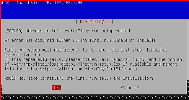

  • When checking progress by connecting a monitor to HDMI port, there is window saying first run has failed and asking to start manual steps.

It is not letting me to open a new SSH connection for second tty. Tried with both root & dietpi users (and dietpi password) but getting ‘access denied’ error.

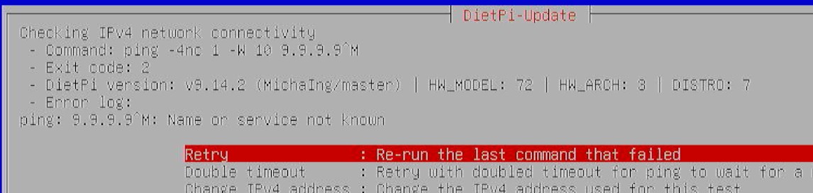

On tty with HDMI connection, clicked OK to continue with manual installation but it gets stuck at network connection stage with weird ping error suggesting unable to ping to 9.9.9.9 DNS. See the screenshot.
I flashed it one more time and tried changing DNS checks to 8.8.8.8 and dns.google.com but failed again at the same stage.

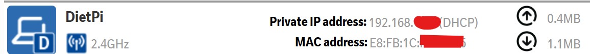

I checked on router and can see it connected OK but strangely hostname as DietPi and not with hostname set in dietpi.txt. See screenshot.

But when I look at the screenshot, I see
ping: 9.9.9.9^M
which is not a valid IP nor hostname
So I guess you edited dietpi.txt in a windows environment, which handles new lines differently than under linux, which causes this weird ^M character in linux.
So you would need to edit it in some Linux environment
OR
some editors have options to save it in unix format. Like Notepad++ has this functionality
Edit → EOL Conversion → Unix (LF)
yes probably
Probably same reason why you are not able to login because password has been changed including the hidden character

Well spotted and terrific detective work! I have been used to Notepad on Windows, didn’t have issues in the past but perhaps after lot of copy paste and edits it may have gone really bad with line breaks.
This is million dollar tip! Thanks.
I switched to Notepad++, saved dietpi.txt as suggested. The cleaned up file indeed worked on fresh install and auto setup completed flawlessly!
