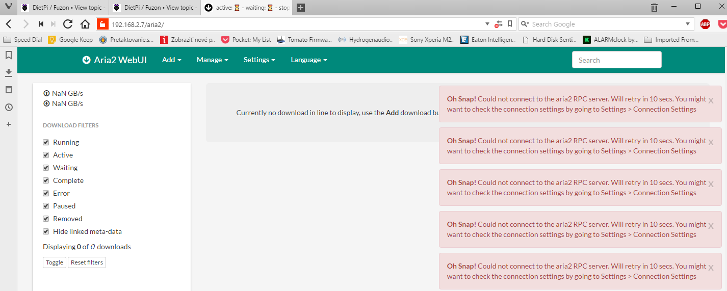

Hi the aria2 webui cannot connect to the aria2 server, I am constantly getting the error
Could not connect to the aria2 RPC server. Will retry in 10 secs. You might want to check the connection settings by going to Settings > Connection Settings
I have tried to change the ports in connection settings, adding the secret token, but no avail. I was not able to figure out where the configurations for the aria2 service are stored. Any hints on this?
Thanks

RPi3. But if you point me to the location of the service config I may fix it myself

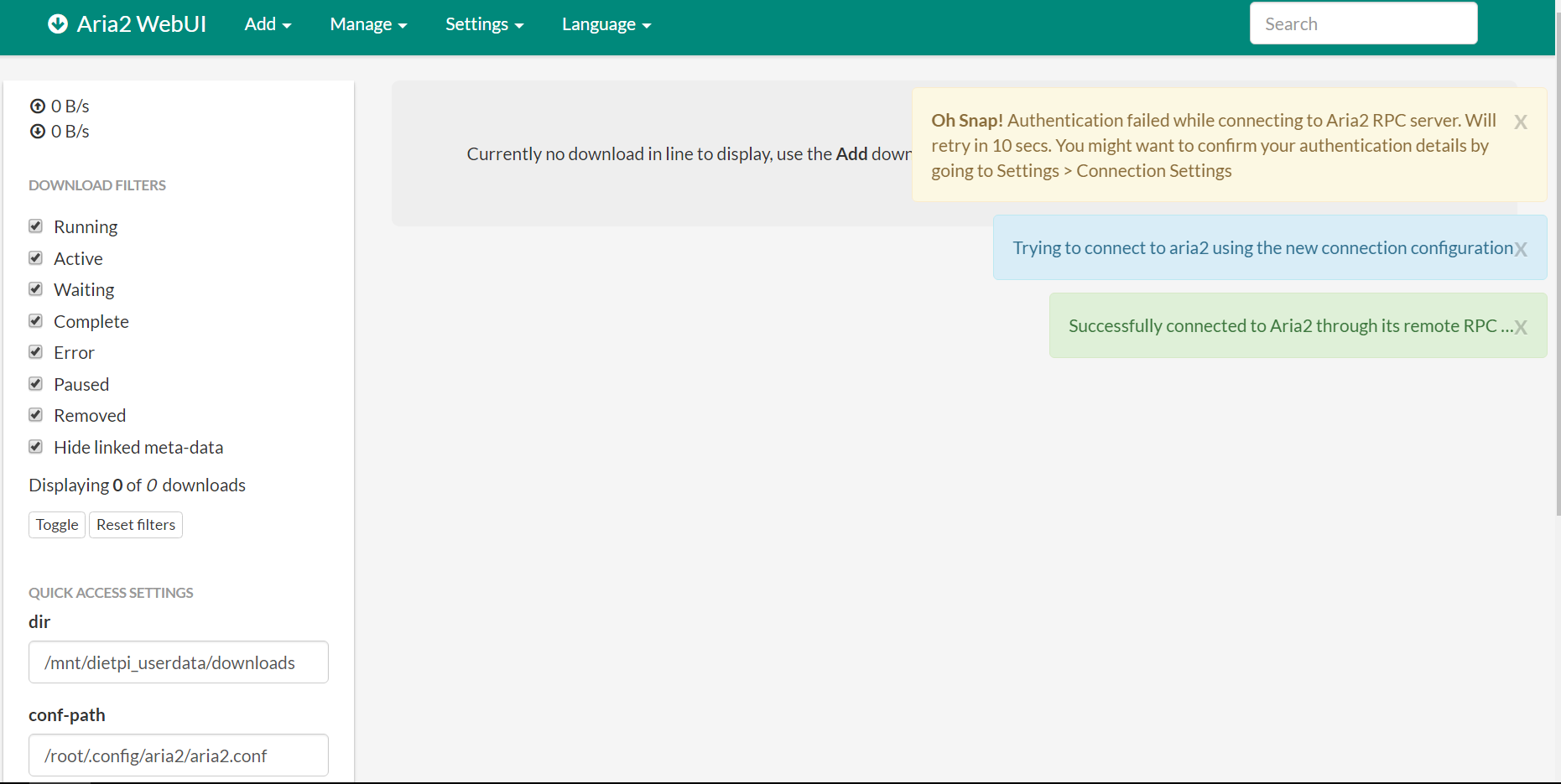

Please see online doc to enter RPC password/key, this will resolve the issue:
https://dietpi.com/forum/t/dietpi-for-vmware-virtual-machine/83/1

of course I have followed the docs and entered the security token. I am not having an authentication error (like on your screenshot) a but a connection error.
