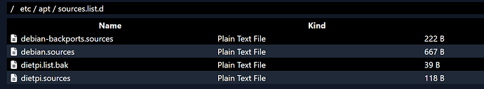

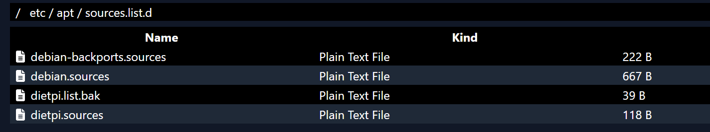

No, this was just the conversion to DEB822 I was expecting. But indeed, it does a very bad job, no idea why:

That is a pretty inefficient “modernization”. That multiple suites are possible per block, instead of previously only 1 suite per line (duplicating the components), is one of the arguments for this new format. It however almost only applies to the Debian repo itself, while 3rd party repos almost never use multiple suites anyway. And then this apt modernize-sources does not even make use of this possibility but creates an own block for every suite instead. Just tested on Forky, and it has not become better. Hence 4 lines become 24 lines :smile:. However, as said, we will do this via dietpi-update once our scripts support it, making use of the DEB822 formatting features.
For you to revert:
  • Delete all *.sources files
  • Restore all *.bak files
There is a /etc/apt/sources.list.bak as well, right?

Exactly what it says there. Delete all *.sources files and rename the *.bak files, like removing the *.bak at the end so that they are pure *.list files again.
Or like this:
cd /etc/apt
rm -v sources.list.d/*.sources
for i in *.list.bak sources.list.d/*.list.bak; do mv -v "$i" "${i%.bak}"; done
apt update # for testing

Torben
Please check whether there are still files ending *.sources in the folder /etc/apt / and its subfolder /etc/apt/sources.list.d/.
