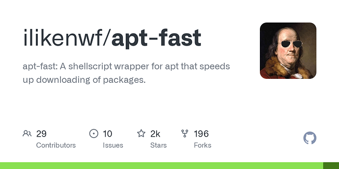

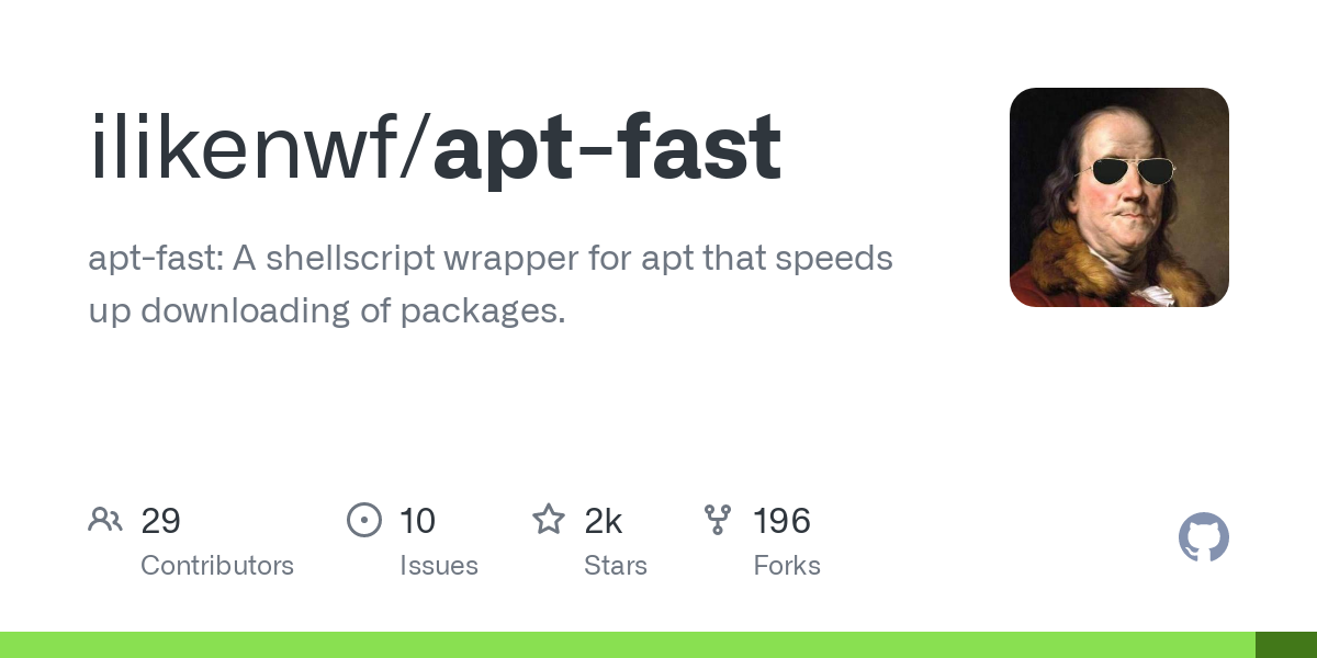

apt-fast: A shellscript wrapper for apt that speeds up downloading of packages.
apt-fast is a shellscript wrapper for apt-get and aptitude that can drastically improve apt download times by downloading packages in parallel, with multiple connections per package.
Might use that to make initial updates and whatnot alot faster, at least on the download side of things
