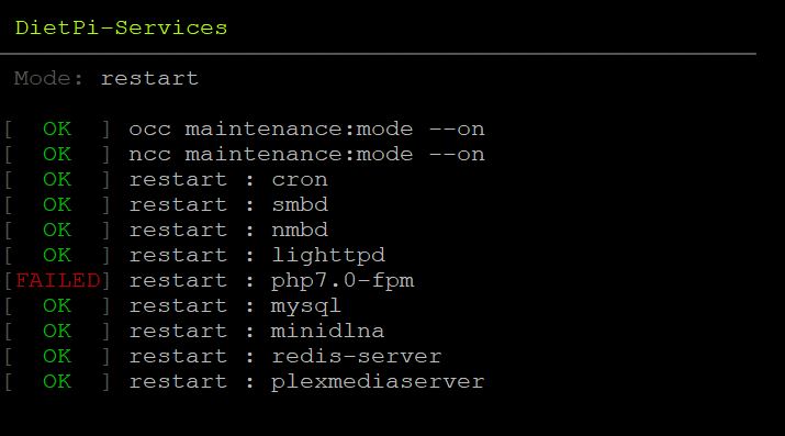

I also found php7.0-fpm cannot start, I cannot run owncloud of nextcloud without php!
Please help!
Found the cause of Php, when both owncloud and nextcloud are installed, php will not start! Maybe I am supposed to install one of the cloud?
Yep, please only install one, we do not support dual configuration/operation of both these titles at the same time.
Best bet is to uninstall both, then reinstall the one you require.
Actually it should be possible to install both. This was the case during many of my testing installations. But I will try/investigate again, especially with Lighttpd.
As long as I am not at home for testing: Could you paste the contents of:
  • /etc/php/7.0/mods-available/apcu.ini
  • /etc/php/7.0/mods-available/opcache.ini
  • and output of: systemctl status php7.0-fpm
