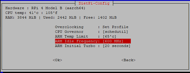

I changed it in the dietpi-config menu. Now it is
arm_freq_min=600
Looks good so far. Thanks for your help.

Could you please elaborate? DietPi-Performance > Overclocking ? DietPi-Performance > Overclocking > CPU Governor ? Default values in a RPi3B are default and schedutil respectively. ondemand and conservative CPU Governor settings seems to set a mininum of 600, whichever is more suited for your SBC. Thank you in advance.
I think he’s talkin about dietpi-config > 4 : Advanced Options > ARM Idle Frequency: [600 MHz]
Exactly.
And you did reboot after changing it?
yes
Probably the issue is not the CPU frequency then. Could you test whether the same happens with performance governor?
