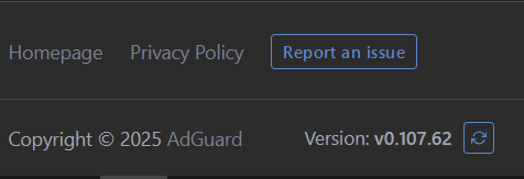

After all that I still see older version:
sudo ./AdGuardHome --version
AdGuard Home, version v0.107.57

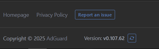

In the WebUI it still shows newer version:
did you already clear your browser cache?
I tried in different browsers that i never opened it. Did the same steps again to be sure and now i got the correct version..
does the old version is behaving differently?
Im giving it a try for a few hours to seeβ¦
So far so good⦠nothing seems to be broken⦠Maybe I could try using unbound again?
Installed Unbound again and everything seems to be back to normal⦠AGH v0.167.62 seems to be broken with hiccups and a lot of disconnections⦠so far version v0.107.57 is the last one I found more stable for me.

I mixed it up , one of these executables which cannot be told to consistently operate on another directory than the one it is located.
Here is the reason why a reinstall did not update it:
w0rtez:
[ INFO ] DietPi-Software | AdGuard Home executable "/mnt/dietpi_userdata/adguardhome/AdGuardHome" already exists. Download and install steps will be skipped.
- If you want to update AdGuard Home, please use the internal updater from web UI.
- If you need to reinstall (e.g. broken instance), please manually remove the executable "/mnt/dietpi_userdata/adguardhome/AdGuardHome" and rerun "dietpi-software (re)install 126".
If there is an updater embedded, we often do not update software during a reinstall, but only do setup around it, since there might be reasonable steps involved by the embedded updater. However, overall I think it causes more issues/confusion than it helps.
Not sure what AdGuardHome -s install or AdGuardHome -s uninstall do, and their output is not helpful either. Maybe they just check for, create or remove a systemd service?
So to install a particular version:
systemctl stop adguardhome
mv ./new/AdGuardHome /mnt/dietpi_userdata/adguardhome/AdGuardHome
systemctl start adguardhome
Regarding the issue: did/do you explicitly have (upstream) DoH enabled, using AdGuardβs own DoH server? Because logs are full of
received addr=https://family.adguard-dns.com:443/dns-query ... timeout
with relatively few request to Unbound or Quad9. Maybe it uses either own DoH as fallback, but either it suffers from the same issue, or it even causes the issue. If you do not configure this explicitly, does the older/functional AdGuard Home do these queries as well? And is there an option to disable upstream DoH entirely (means that the related Quad9 upstream would not work anymore), and does it help?
