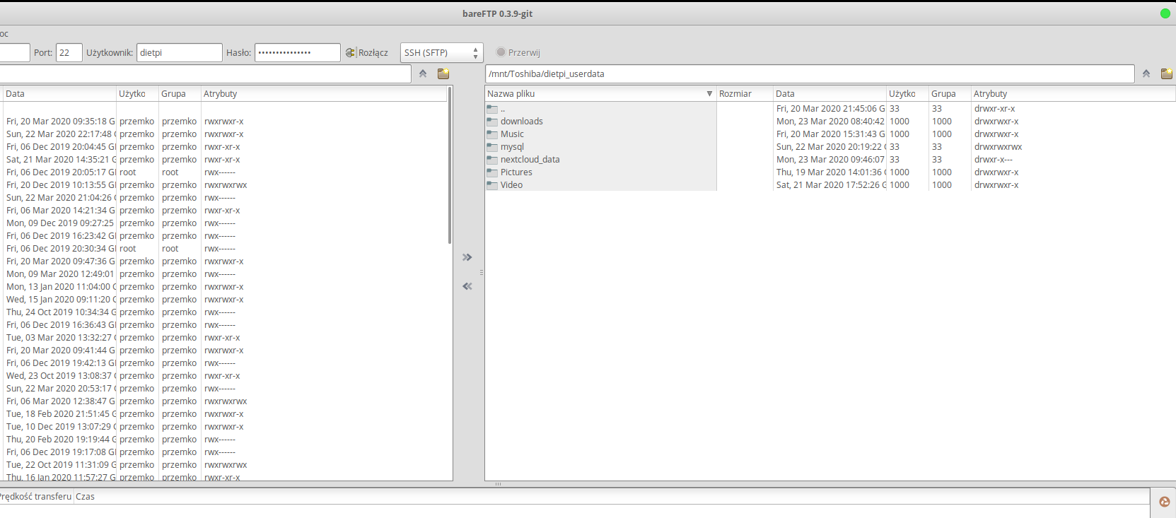

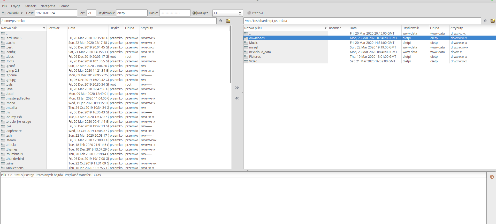

Yes, that is correct but when I login with FTP I cannot. That is also when I login with SSH. I must use sudo. Maybe it’s because I format that drive from my linux laptop. I also add permissions for www-data user and dietpi user. Maybe I made it wrong. I’m not good at that stuff :confused:
pls can you login using FTP and try to create a folder? How does the user permissions of this looks like afterwards?
As I say I cannot create, delete folders when login with ftp or ssh on that drive.
pls can you login using FTP port 21. You are going to login directly to your DietPi system right?
The same situation:

as I can see you give permission 777 (r/w to everybody) to dietpi_userdata. Did you have done this now? Because on a screen shot before it was looking different. There it was user www-data only who could write to this folder
I give permissions when I install nextcloud. I didn’t change it now.
I would give permission to user dietpi. www-data should be fine for nextcloud folder only. No need to give it to entire user_data directory
