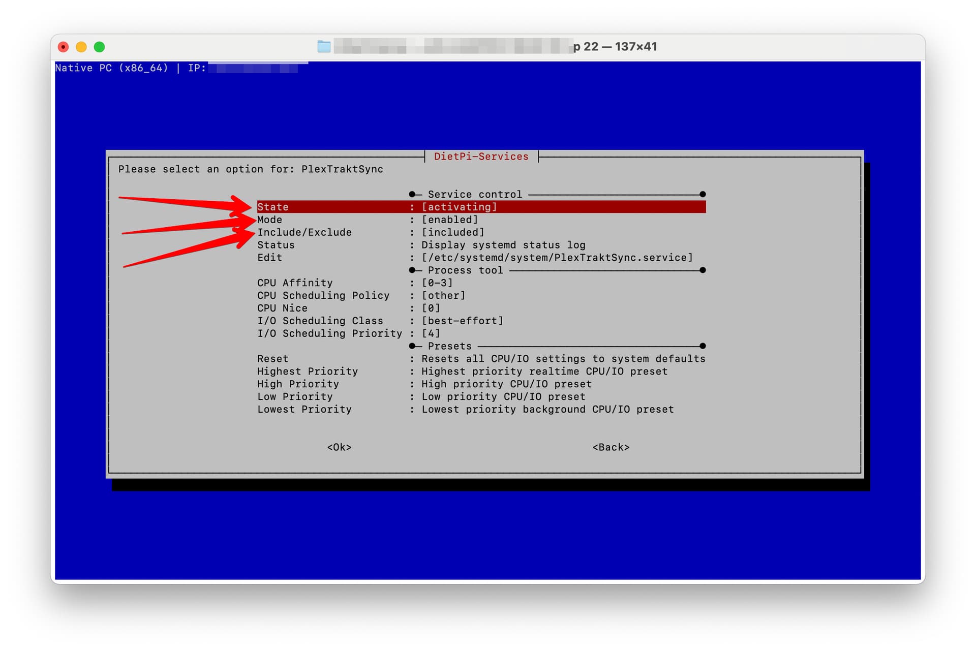

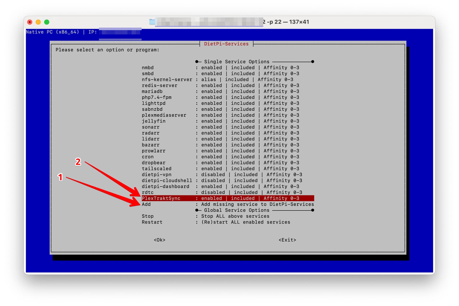

then I went into the
dietpi-launcher
into the services tab and “add” the PlexTraktSync (without .service)

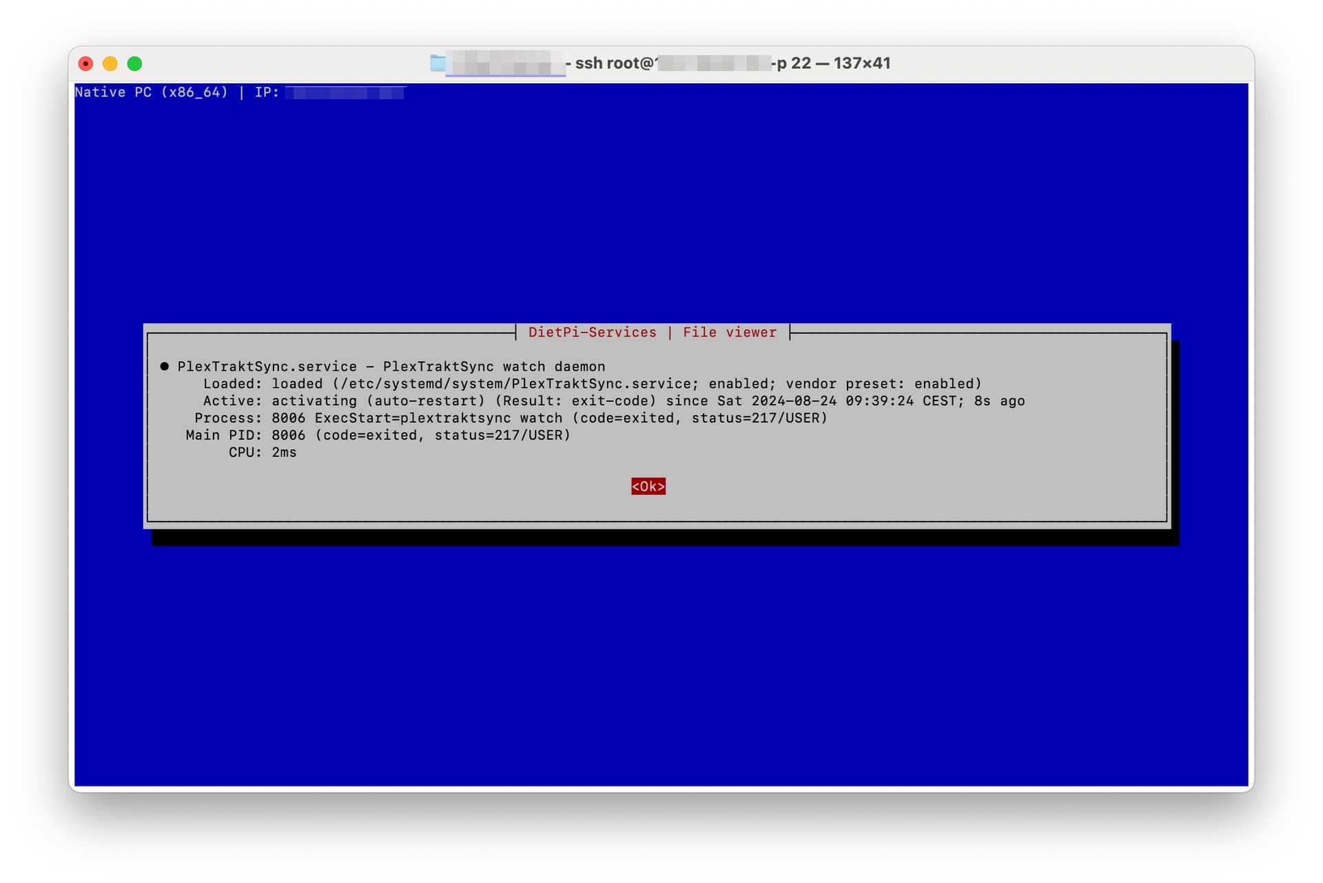

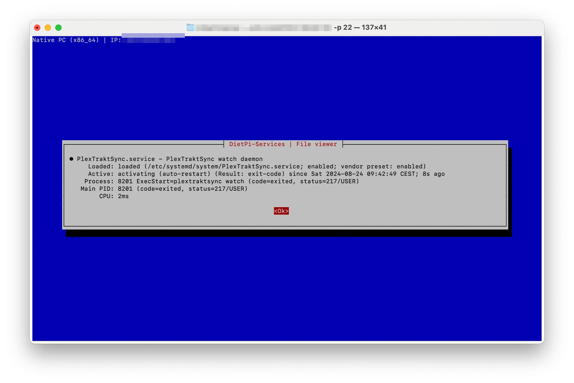

and turned everything on. but State stucks on “activating”
Status Output:
so I did a reboot and hoped I would not need to type
plextraktsync watch
and it would run/start automatically…it did not.

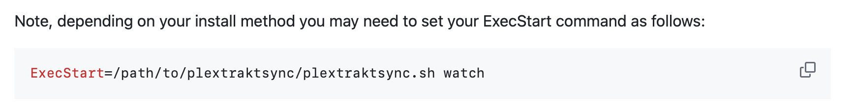

I did not do this step:
since I am not understanding what this means/does. May this be the culprit?
When you Look at dietpi-launcher - Services there is the Point “Status” there are you can read / Look Up why your Service dont start or why it start with a Error
The secound Point is execstart
This Differenz is the folder path
Some Linux App can use Its one path for install so when you have execstart=plex.sh watch , Linux maybe dont know the folder where It can find the sh File
You can check the the logs with journalctl -u PlexTraktSync.service.

here is what I get out if I check out the status:
gives me:
root@DietPi:~# journalctl -u PlexTraktSync.service
-- Journal begins at Sat 2024-08-24 08:41:15 CEST, ends at Sat 2024-08-24 08:58:45 CEST. --
Aug 24 08:43:45 DietPi systemd[1]: Started PlexTraktSync watch daemon.
Aug 24 08:43:45 DietPi systemd[4006]: PlexTraktSync.service: Failed to determine user credentials: No such process
Aug 24 08:43:45 DietPi systemd[4006]: PlexTraktSync.service: Failed at step USER spawning plextraktsync: No such process
Aug 24 08:43:45 DietPi systemd[1]: PlexTraktSync.service: Main process exited, code=exited, status=217/USER
Aug 24 08:43:45 DietPi systemd[1]: PlexTraktSync.service: Failed with result 'exit-code'.
Aug 24 08:43:55 DietPi systemd[1]: PlexTraktSync.service: Scheduled restart job, restart counter is at 1.
Aug 24 08:43:55 DietPi systemd[1]: Stopped PlexTraktSync watch daemon.
Aug 24 08:43:55 DietPi systemd[1]: Started PlexTraktSync watch daemon.
Aug 24 08:43:55 DietPi systemd[4049]: PlexTraktSync.service: Failed to determine user credentials: No such process
Aug 24 08:43:55 DietPi systemd[4049]: PlexTraktSync.service: Failed at step USER spawning plextraktsync: No such process
Aug 24 08:43:55 DietPi systemd[1]: PlexTraktSync.service: Main process exited, code=exited, status=217/USER
Aug 24 08:43:55 DietPi systemd[1]: PlexTraktSync.service: Failed with result 'exit-code'.
Aug 24 08:44:05 DietPi systemd[1]: PlexTraktSync.service: Scheduled restart job, restart counter is at 2.
Aug 24 08:44:05 DietPi systemd[1]: Stopped PlexTraktSync watch daemon.
Aug 24 08:44:05 DietPi systemd[1]: Started PlexTraktSync watch daemon.
Aug 24 08:44:05 DietPi systemd[4078]: PlexTraktSync.service: Failed to determine user credentials: No such process
Aug 24 08:44:05 DietPi systemd[4078]: PlexTraktSync.service: Failed at step USER spawning plextraktsync: No such process
Aug 24 08:44:05 DietPi systemd[1]: PlexTraktSync.service: Main process exited, code=exited, status=217/USER
Aug 24 08:44:05 DietPi systemd[1]: PlexTraktSync.service: Failed with result 'exit-code'.
Aug 24 08:44:15 DietPi systemd[1]: PlexTraktSync.service: Scheduled restart job, restart counter is at 3.
Aug 24 08:44:15 DietPi systemd[1]: Stopped PlexTraktSync watch daemon.
Aug 24 08:44:15 DietPi systemd[1]: Started PlexTraktSync watch daemon.
Aug 24 08:44:15 DietPi systemd[4111]: PlexTraktSync.service: Failed to determine user credentials: No such process
Aug 24 08:44:15 DietPi systemd[4111]: PlexTraktSync.service: Failed at step USER spawning plextraktsync: No such process
Aug 24 08:44:15 DietPi systemd[1]: PlexTraktSync.service: Main process exited, code=exited, status=217/USER
Aug 24 08:44:15 DietPi systemd[1]: PlexTraktSync.service: Failed with result 'exit-code'.
Aug 24 08:44:25 DietPi systemd[1]: PlexTraktSync.service: Scheduled restart job, restart counter is at 4.
Aug 24 08:44:25 DietPi systemd[1]: Stopped PlexTraktSync watch daemon.
Aug 24 08:44:25 DietPi systemd[1]: Started PlexTraktSync watch daemon.
Aug 24 08:44:25 DietPi systemd[4140]: PlexTraktSync.service: Failed to determine user credentials: No such process
Aug 24 08:44:25 DietPi systemd[4140]: PlexTraktSync.service: Failed at step USER spawning plextraktsync: No such process
Aug 24 08:44:25 DietPi systemd[1]: PlexTraktSync.service: Main process exited, code=exited, status=217/USER
Aug 24 08:44:25 DietPi systemd[1]: PlexTraktSync.service: Failed with result 'exit-code'.
Aug 24 08:44:36 DietPi systemd[1]: PlexTraktSync.service: Scheduled restart job, restart counter is at 5.
Aug 24 08:44:36 DietPi systemd[1]: Stopped PlexTraktSync watch daemon.
Aug 24 08:44:36 DietPi systemd[1]: Started PlexTraktSync watch daemon.
Aug 24 08:44:36 DietPi systemd[4144]: PlexTraktSync.service: Failed to determine user credentials: No such process
Aug 24 08:44:36 DietPi systemd[4144]: PlexTraktSync.service: Failed at step USER spawning plextraktsync: No such process
Aug 24 08:44:36 DietPi systemd[1]: PlexTraktSync.service: Main process exited, code=exited, status=217/USER
Aug 24 08:44:36 DietPi systemd[1]: PlexTraktSync.service: Failed with result 'exit-code'.

Aug 25 08:27:52 DietPi systemd[1]: Started PlexTraktSync watch daemon.
Aug 25 08:27:52 DietPi systemd[4576]: PlexTraktSync.service: Failed to locate executable plextraktsync: No such file or directory
Aug 25 08:27:52 DietPi systemd[4576]: **PlexTraktSync.service: Failed at step EXEC spawning plextraktsync: No such file or directory**
Aug 25 08:27:52 DietPi systemd[1]: **PlexTraktSync.service: Main process exited, code=exited, status=203/EXEC**
Aug 25 08:27:52 DietPi systemd[1]: **PlexTraktSync.service: Failed with result 'exit-code'.**
Aug 25 08:28:02 DietPi systemd[1]: PlexTraktSync.service: Scheduled restart job, restart counter is at 8.
Aug 25 08:28:02 DietPi systemd[1]: Stopped PlexTraktSync watch daemon.
Aug 25 08:28:02 DietPi systemd[1]: Started PlexTraktSync watch daemon.
Aug 25 08:28:02 DietPi systemd[4585]: PlexTraktSync.service: Failed to locate executable plextraktsync: No such file or directory
Aug 25 08:28:02 DietPi systemd[4585]: **PlexTraktSync.service: Failed at step EXEC spawning plextraktsync: No such file or directory**
Aug 25 08:28:02 DietPi systemd[1]: **PlexTraktSync.service: Main process exited, code=exited, status=203/EXEC**
Aug 25 08:28:02 DietPi systemd[1]: **PlexTraktSync.service: Failed with result 'exit-code'.**
Aug 25 08:28:12 DietPi systemd[1]: PlexTraktSync.service: Scheduled restart job, restart counter is at 9.
Aug 25 08:28:12 DietPi systemd[1]: Stopped PlexTraktSync watch daemon.
Aug 25 08:28:12 DietPi systemd[1]: Started PlexTraktSync watch daemon.
Aug 25 08:28:12 DietPi systemd[4590]: PlexTraktSync.service: Failed to locate executable plextraktsync: No such file or directory
Aug 25 08:28:12 DietPi systemd[4590]: **PlexTraktSync.service: Failed at step EXEC spawning plextraktsync: No such file or directory**
Aug 25 08:28:12 DietPi systemd[1]: **PlexTraktSync.service: Main process exited, code=exited, status=203/EXEC**
Aug 25 08:28:12 DietPi systemd[1]: **PlexTraktSync.service: Failed with result 'exit-code'.**
Aug 25 08:28:22 DietPi systemd[1]: PlexTraktSync.service: Scheduled restart job, restart counter is at 10.
Aug 25 08:28:22 DietPi systemd[1]: Stopped PlexTraktSync watch daemon.
Aug 25 08:28:22 DietPi systemd[1]: Started PlexTraktSync watch daemon.
Aug 25 08:28:22 DietPi systemd[4596]: PlexTraktSync.service: Failed to locate executable plextraktsync: No such file or directory
Aug 25 08:28:22 DietPi systemd[4596]: **PlexTraktSync.service: Failed at step EXEC spawning plextraktsync: No such file or directory**
Aug 25 08:28:22 DietPi systemd[1]: **PlexTraktSync.service: Main process exited, code=exited, status=203/EXEC**
Aug 25 08:28:22 DietPi systemd[1]: **PlexTraktSync.service: Failed with result 'exit-code'.**
Aug 25 08:28:32 DietPi systemd[1]: PlexTraktSync.service: Scheduled restart job, restart counter is at 11.
Aug 25 08:28:32 DietPi systemd[1]: Stopped PlexTraktSync watch daemon.
Aug 25 08:28:32 DietPi systemd[1]: Started PlexTraktSync watch daemon.
Aug 25 08:28:32 DietPi systemd[4599]: PlexTraktSync.service: Failed to locate executable plextraktsync: No such file or directory
Aug 25 08:28:32 DietPi systemd[4599]: **PlexTraktSync.service: Failed at step EXEC spawning plextraktsync: No such file or directory**
Aug 25 08:28:32 DietPi systemd[1]: **PlexTraktSync.service: Main process exited, code=exited, status=203/EXEC**
Aug 25 08:28:32 DietPi systemd[1]: **PlexTraktSync.service: Failed with result 'exit-code'.**
Aug 25 08:28:43 DietPi systemd[1]: PlexTraktSync.service: Scheduled restart job, restart counter is at 12.
Aug 25 08:28:43 DietPi systemd[1]: Stopped PlexTraktSync watch daemon.
Aug 25 08:28:43 DietPi systemd[1]: Started PlexTraktSync watch daemon.
Aug 25 08:28:43 DietPi systemd[4605]: PlexTraktSync.service: Failed to locate executable plextraktsync: No such file or directory
Aug 25 08:28:43 DietPi systemd[4605]: **PlexTraktSync.service: Failed at step EXEC spawning plextraktsync: No such file or directory**
Aug 25 08:28:43 DietPi systemd[1]: **PlexTraktSync.service: Main process exited, code=exited, status=203/EXEC**
Aug 25 08:28:43 DietPi systemd[1]: **PlexTraktSync.service: Failed with result 'exit-code'.**
Aug 25 08:28:53 DietPi systemd[1]: PlexTraktSync.service: Scheduled restart job, restart counter is at 13.
Aug 25 08:28:53 DietPi systemd[1]: Stopped PlexTraktSync watch daemon.
Aug 25 08:28:53 DietPi systemd[1]: Started PlexTraktSync watch daemon.
Aug 25 08:28:53 DietPi systemd[4606]: PlexTraktSync.service: Failed to locate executable plextraktsync: No such file or directory
Aug 25 08:28:53 DietPi systemd[4606]: **PlexTraktSync.service: Failed at step EXEC spawning plextraktsync: No such file or directory**
Aug 25 08:28:53 DietPi systemd[1]: **PlexTraktSync.service: Main process exited, code=exited, status=203/EXEC**
Aug 25 08:28:53 DietPi systemd[1]: **PlexTraktSync.service: Failed with result 'exit-code'.**
Aug 25 08:29:03 DietPi systemd[1]: PlexTraktSync.service: Scheduled restart job, restart counter is at 14.
Aug 25 08:29:03 DietPi systemd[1]: Stopped PlexTraktSync watch daemon.
Aug 25 08:29:03 DietPi systemd[1]: Started PlexTraktSync watch daemon.
Aug 25 08:29:03 DietPi systemd[4608]: PlexTraktSync.service: Failed to locate executable plextraktsync: No such file or directory
Aug 25 08:29:03 DietPi systemd[4608]: **PlexTraktSync.service: Failed at step EXEC spawning plextraktsync: No such file or directory**
Aug 25 08:29:03 DietPi systemd[1]: **PlexTraktSync.service: Main process exited, code=exited, status=203/EXEC**
Aug 25 08:29:03 DietPi systemd[1]: **PlexTraktSync.service: Failed with result 'exit-code'.**
Aug 25 08:29:13 DietPi systemd[1]: PlexTraktSync.service: Scheduled restart job, restart counter is at 15.
Aug 25 08:29:13 DietPi systemd[1]: Stopped PlexTraktSync watch daemon.
Aug 25 08:29:13 DietPi systemd[1]: Started PlexTraktSync watch daemon.
Aug 25 08:29:13 DietPi systemd[4613]: PlexTraktSync.service: Failed to locate executable plextraktsync: No such file or directory
Aug 25 08:29:13 DietPi systemd[4613]: **PlexTraktSync.service: Failed at step EXEC spawning plextraktsync: No such file or directory**
Aug 25 08:29:13 DietPi systemd[1]: **PlexTraktSync.service: Main process exited, code=exited, status=203/EXEC**
Aug 25 08:29:13 DietPi systemd[1]: **PlexTraktSync.service: Failed with result 'exit-code'.**
Aug 25 08:29:24 DietPi systemd[1]: PlexTraktSync.service: Scheduled restart job, restart counter is at 16.
Aug 25 08:29:24 DietPi systemd[1]: Stopped PlexTraktSync watch daemon.
Aug 25 08:29:24 DietPi systemd[1]: Started PlexTraktSync watch daemon.
Aug 25 08:29:24 DietPi systemd[4622]: PlexTraktSync.service: Failed to locate executable plextraktsync: No such file or directory
Aug 25 08:29:24 DietPi systemd[4622]: **PlexTraktSync.service: Failed at step EXEC spawning plextraktsync: No such file or directory**
Aug 25 08:29:24 DietPi systemd[1]: **PlexTraktSync.service: Main process exited, code=exited, status=203/EXEC**
Aug 25 08:29:24 DietPi systemd[1]: **PlexTraktSync.service: Failed with result 'exit-code'.**
Aug 25 08:29:34 DietPi systemd[1]: PlexTraktSync.service: Scheduled restart job, restart counter is at 17.
Aug 25 08:29:34 DietPi systemd[1]: Stopped PlexTraktSync watch daemon.
Aug 25 08:29:34 DietPi systemd[1]: Started PlexTraktSync watch daemon.
Aug 25 08:29:34 DietPi systemd[4626]: PlexTraktSync.service: Failed to locate executable plextraktsync: No such file or directory
Aug 25 08:29:34 DietPi systemd[4626]: **PlexTraktSync.service: Failed at step EXEC spawning plextraktsync: No such file or directory**
Aug 25 08:29:34 DietPi systemd[1]: **PlexTraktSync.service: Main process exited, code=exited, status=203/EXEC**
Aug 25 08:29:34 DietPi systemd[1]: **PlexTraktSync.service: Failed with result 'exit-code'.**
Aug 25 08:29:44 DietPi systemd[1]: PlexTraktSync.service: Scheduled restart job, restart counter is at 18.
Aug 25 08:29:44 DietPi systemd[1]: Stopped PlexTraktSync watch daemon.
Aug 25 08:29:44 DietPi systemd[1]: Started PlexTraktSync watch daemon.
Aug 25 08:29:44 DietPi systemd[4630]: PlexTraktSync.service: Failed to locate executable plextraktsync: No such file or directory
Aug 25 08:29:44 DietPi systemd[4630]: **PlexTraktSync.service: Failed at step EXEC spawning plextraktsync: No such file or directory**
Aug 25 08:29:44 DietPi systemd[1]: **PlexTraktSync.service: Main process exited, code=exited, status=203/EXEC**
Aug 25 08:29:44 DietPi systemd[1]: **PlexTraktSync.service: Failed with result 'exit-code'.**
Aug 25 08:29:54 DietPi systemd[1]: PlexTraktSync.service: Scheduled restart job, restart counter is at 19.
Aug 25 08:29:54 DietPi systemd[1]: Stopped PlexTraktSync watch daemon.
Aug 25 08:29:54 DietPi systemd[1]: Started PlexTraktSync watch daemon.
Aug 25 08:29:54 DietPi systemd[4633]: PlexTraktSync.service: Failed to locate executable plextraktsync: No such file or directory
Aug 25 08:29:54 DietPi systemd[4633]: **PlexTraktSync.service: Failed at step EXEC spawning plextraktsync: No such file or directory**
Aug 25 08:29:54 DietPi systemd[1]: **PlexTraktSync.service: Main process exited, code=exited, status=203/EXEC**
Aug 25 08:29:54 DietPi systemd[1]: **PlexTraktSync.service: Failed with result 'exit-code'.**
Aug 25 08:30:05 DietPi systemd[1]: PlexTraktSync.service: Scheduled restart job, restart counter is at 20.
Aug 25 08:30:05 DietPi systemd[1]: Stopped PlexTraktSync watch daemon.
Aug 25 08:30:05 DietPi systemd[1]: Started PlexTraktSync watch daemon.
Aug 25 08:30:05 DietPi systemd[4646]: PlexTraktSync.service: Failed to locate executable plextraktsync: No such file or directory
Aug 25 08:30:05 DietPi systemd[4646]: **PlexTraktSync.service: Failed at step EXEC spawning plextraktsync: No such file or directory**
Aug 25 08:30:05 DietPi systemd[1]: **PlexTraktSync.service: Main process exited, code=exited, status=203/EXEC**
Aug 25 08:30:05 DietPi systemd[1]: **PlexTraktSync.service: Failed with result 'exit-code'.**
Aug 25 08:30:15 DietPi systemd[1]: PlexTraktSync.service: Scheduled restart job, restart counter is at 21.
Aug 25 08:30:15 DietPi systemd[1]: Stopped PlexTraktSync watch daemon.
Aug 25 08:30:15 DietPi systemd[1]: Started PlexTraktSync watch daemon.
Aug 25 08:30:15 DietPi systemd[4650]: PlexTraktSync.service: Failed to locate executable plextraktsync: No such file or directory
Aug 25 08:30:15 DietPi systemd[4650]: **PlexTraktSync.service: Failed at step EXEC spawning plextraktsync: No such file or directory**
Aug 25 08:30:15 DietPi systemd[1]: **PlexTraktSync.service: Main process exited, code=exited, status=203/EXEC**
Aug 25 08:30:15 DietPi systemd[1]: **PlexTraktSync.service: Failed with result 'exit-code'.**
Aug 25 08:30:25 DietPi systemd[1]: PlexTraktSync.service: Scheduled restart job, restart counter is at 22.
Aug 25 08:30:25 DietPi systemd[1]: Stopped PlexTraktSync watch daemon.
Aug 25 08:30:25 DietPi systemd[1]: Started PlexTraktSync watch daemon.
Aug 25 08:30:25 DietPi systemd[4653]: PlexTraktSync.service: Failed to locate executable plextraktsync: No such file or directory
Aug 25 08:30:25 DietPi systemd[4653]: **PlexTraktSync.service: Failed at step EXEC spawning plextraktsync: No such file or directory**
Aug 25 08:30:25 DietPi systemd[1]: **PlexTraktSync.service: Main process exited, code=exited, status=203/EXEC**
Aug 25 08:30:25 DietPi systemd[1]: **PlexTraktSync.service: Failed with result 'exit-code'.**
yes this is your issue
You would need to specify the full path to where the file is located
I think I literally came to the solution by myself. let me test and see if I found the solution for my first linux issue (im happy :slight_smile: )
ok it works. that’s the right code:
