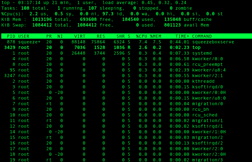

BTW, top didnt show anything strange....resource hog.
