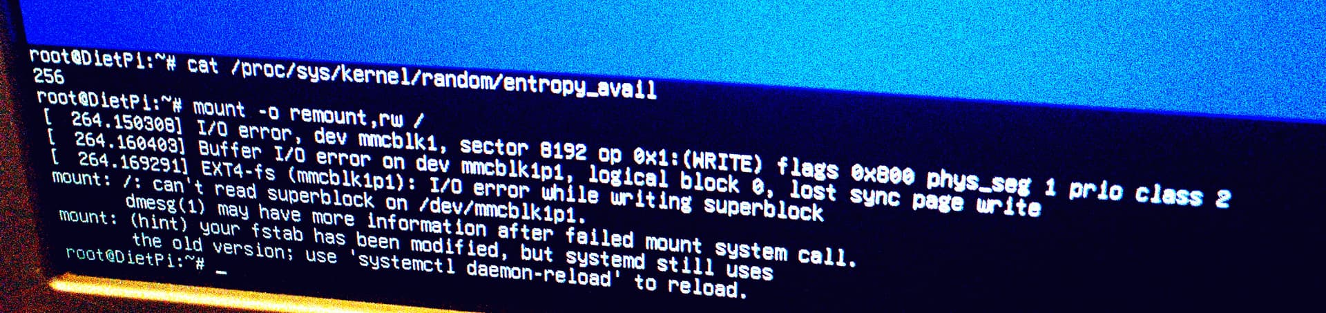

Alright, I tested what you posted @MichaIng, here’s the result:
The kernel messages don’t seem to pause at all, they go up/refresh constantly after the monitor gets a HDMI signal. So I’m not sure what you mean by “when kernel messages stop”
I tried both typing random keys as soon as the kernel messages (with the linux penguins at the top) showed up on screen, and immediately after turning on the XU4. Both had the same result.
After logging in with the default credentials, and failing the step in the setup, I got dropped at the root prompt, so I issued the commands you suggested:
I got the same entropy_avail cat output as you do, and I’m still not able to mount the root partition as writeable, and thus can’t install haveged.

[    4.686539] mmcblk0: mmc0:0001 SD256 118 GiB
[    4.699197] exynos5-dmc 10c20000.memory-controller: error -ENXIO: IRQ drex_0 not found
[    4.705637] exynos5-dmc 10c20000.memory-controller: error -ENXIO: IRQ drex_1 not found
[    4.713777] exynos5-dmc 10c20000.memory-controller: DMC initialized, in irq mode: 0
[    7.830765] I/O error, dev mmcblk0, sector 0 op 0x1:(WRITE) flags 0x800 phys_seg 0 prio class 2
[    7.855616] I/O error, dev mmcblk0, sector 0 op 0x1:(WRITE) flags 0x800 phys_seg 0 prio class 2
[   11.023732] I/O error, dev mmcblk0, sector 8192 op 0x1:(WRITE) flags 0x800 phys_seg 1 prio class 2
[   11.033759] Buffer I/O error on dev mmcblk0p1, logical block 0, lost sync page write
[   11.042993] EXT4-fs (mmcblk0p1): I/O error while writing superblock
It seems to be a particular issue with the SD card.
