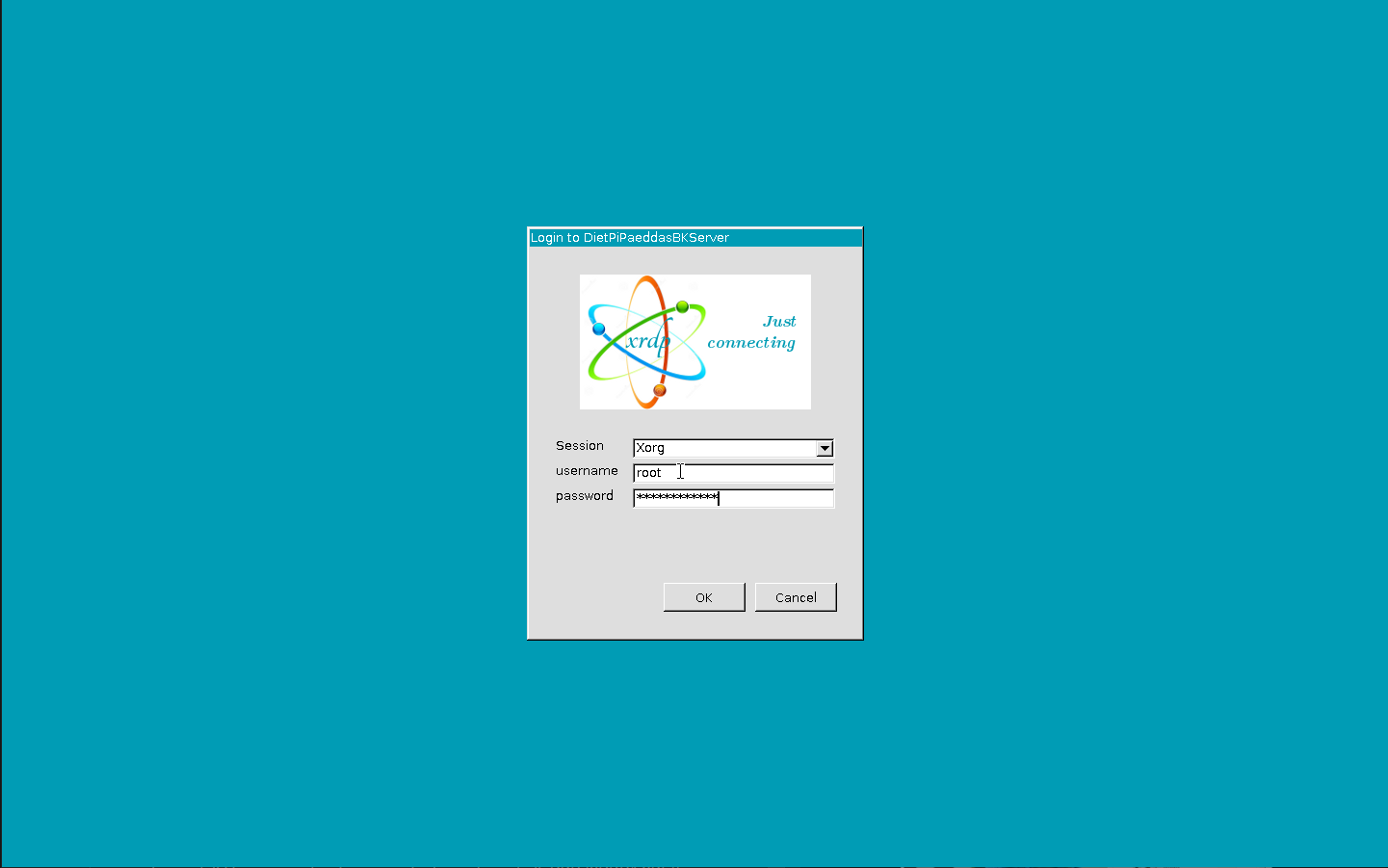

But I can only log in as a normal user, not as root. If I log in as root, only a green display is shown (with RDP (XRDP/LXDE)):
Normal User :
root User:
After hitting log in:
After a timeout:
