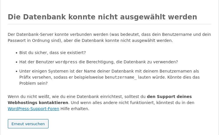

Then after entering the database credentials I get

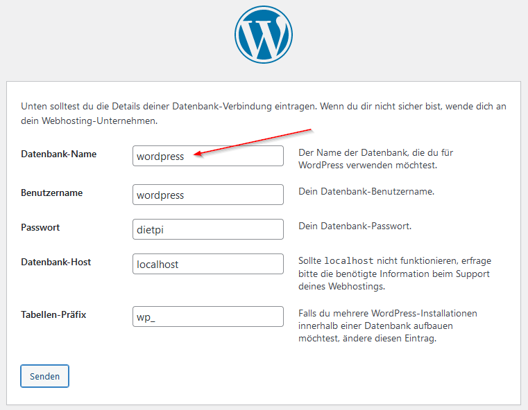

The problem arises, if you do not enter ‘wordpress’ in the first field (see arrow), i.e. you keep the field empty.

Great !
That was exactly the solution for me.
But the first Wordpress is also deceptively real …
Many thanks
yes, the database name needs to be filled in, even if it looks like it’s prefilled. Maybe we would need to make it clear within our docs as these are mandatory fields.
