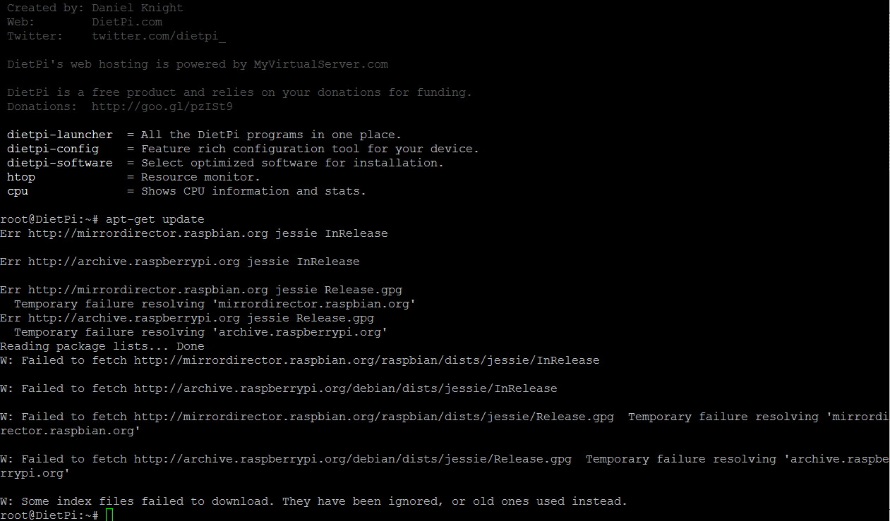

using V117 also break my apt-get update. It throws me an error as well.
Strange. Is it possible the urllib2 library you have is only python3 compatible?
The apt-get update error, could you paste the error or screenshot it please? There may be a issue with a repo that is causing this. Could even be linked to your python issue if packages were installed from various repos.

Please see image when I perform apt-get update after I updated to V117 from V115.
Update: Just realized that ping google.com is not working too, and ping 8.8.8.8 is working.
Thanks.
Looks like your DNS isnt working correctly.

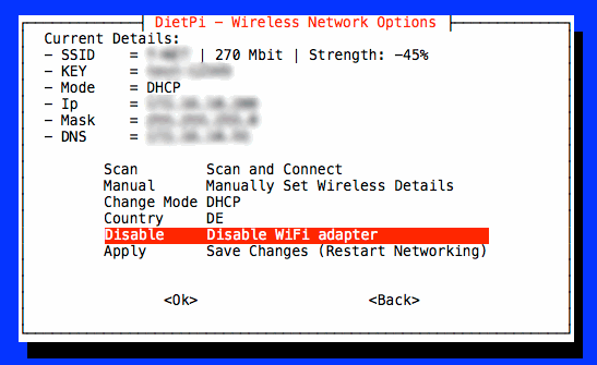

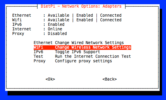

will say, if you want to alter your network settings, please use menu " 7 Network Options: Adapters " in:
root@oDroid-C1-TEST:~# dietpi-config
In this menu you can as well disable WiFi adapter:
Correct is:
# Wifi
#dns-nameservers 8.8.8.8 8.8.4.4
" dietpi-config " did this. Where is no need, to edit " /etc/network/interfaces " manually, to disable WiFi adapter.
But if you edit the file manually before, you have to set it now “once” by hand, so dietpi-config can work correct.
