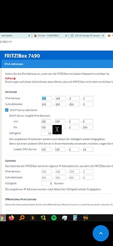

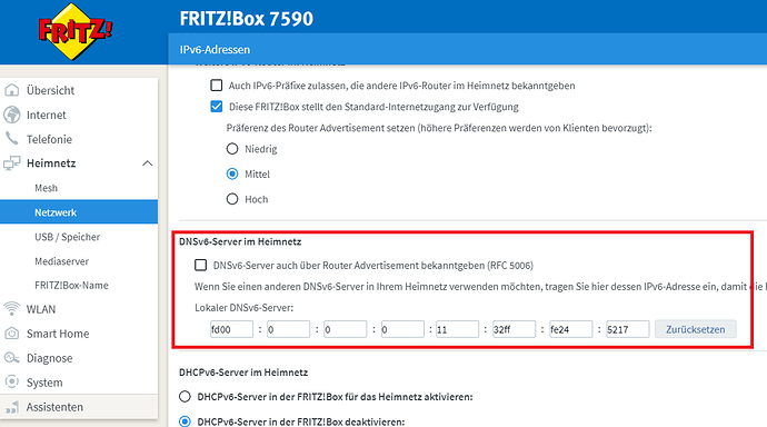

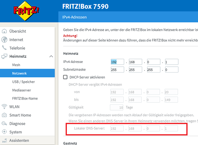

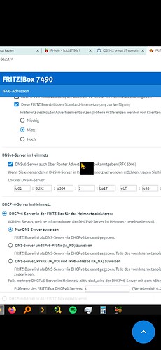

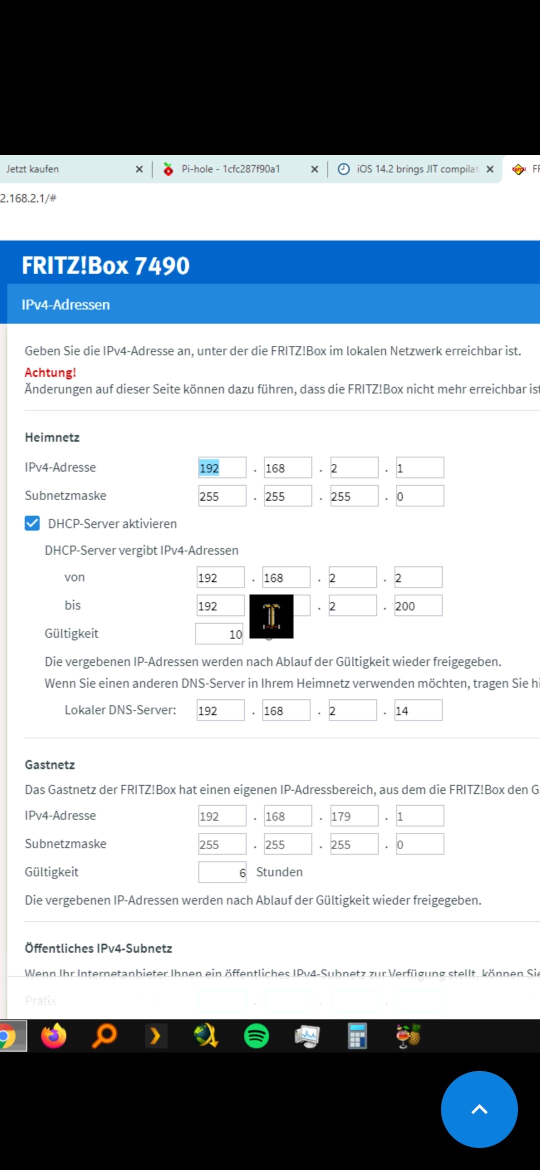

Another option is to distribute PiHole DNS server together with DHCP server settings. This can be done network settings inside your fritz.box
for IPv4
for IPv6
This way, all clients should show up individually on PiHole and not combined as fritz.box. It will allow more detailed settings per client if needed.
DNS of pihole ist already set in v4 and V6. See Attachments. Dunno whats wrong Here.
