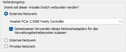

Created new external switch and set it prior installation:
mmc_EY09bhlldI
Is this not the right config?
hmm ok still not working. Just messed up the IP and thought it works but was the other Dietpi system.
Now I even can’t login anymore. It does not accept the newly set password :frowning:
I begin from scratch again.
It seems that I can access every resource except the Host system ones.
Oh man, after days of fight with NFS, EXT4 on Windows, Samba and Linux permissions I finally have an easy solution.
Hope this works now as intended :sweat_smile:
I disabled/enabled Hyper-V.
Created new VM.
Added external adapter.
Assigned static IP and gateway.
The VM can finally also access the Host. As I read this is normally done trough the default (internal) swtich.
No idea why it did not work before.
NFS also working now! :slight_smile:
