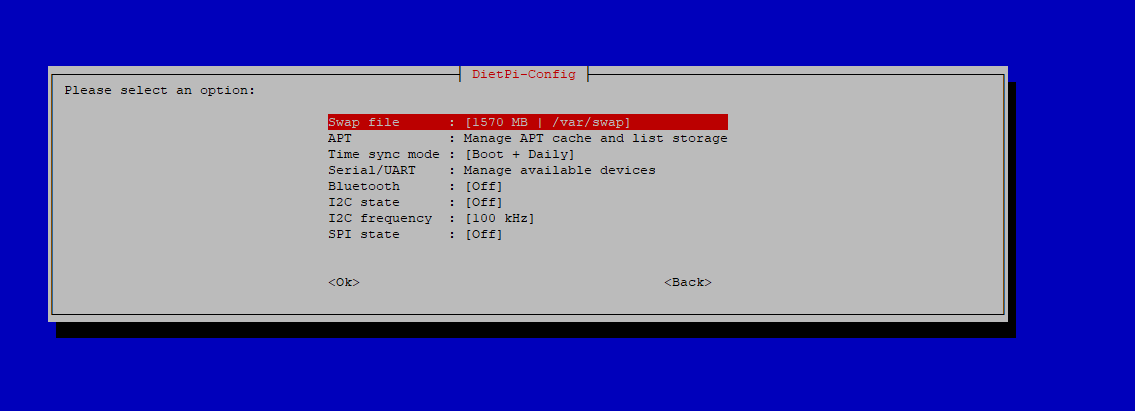

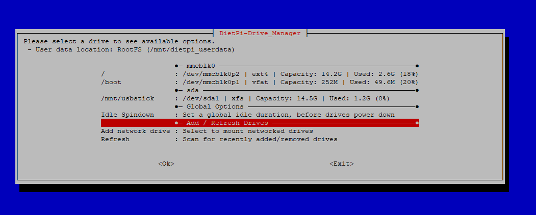

  1. Does it make sense to move my swap files to the USB stick? My DietPi backups are on this stick.
  2. i have a Raspberry 1 Rev B with 512MB RAM for PiHole, Unbound and RPi-Monitor. Swap file also as 1GB sufficient?
I have enough memory on my two 16GB sticks. So it makes no sense to reduce the size of the sawp file, correct?
Thanks
your setup should be fine and usually there should not be a need to change anything. At the moment the SWAP file is not used. But as your system has 512MB RAM only, you should keep it just n case needed at a later stage.
But it’s generally a good idea to move the swap file to the USB stick, since SD cards are not made for surviving long with heavy writes. It practically doesn’t make a difference if the swap file isn’t used, but it may be used during maintenance tasks, software installs etc. 1 GiB seems sufficient as it’s currently not used, but it doesn’t hurt to leave it larger as long as USB drive space is sufficient.
