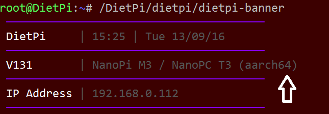

While the “M” models are called NanoPi, the “T” models are called NanoPC, so you may want to change the models’ long description texts one more time…!?
Its mainly a visual thing.
We need to use short descriptions, so the dietpi-banner lines fit on single lines with 320x240 > displays. The purple lines are the max width in 320xXXX

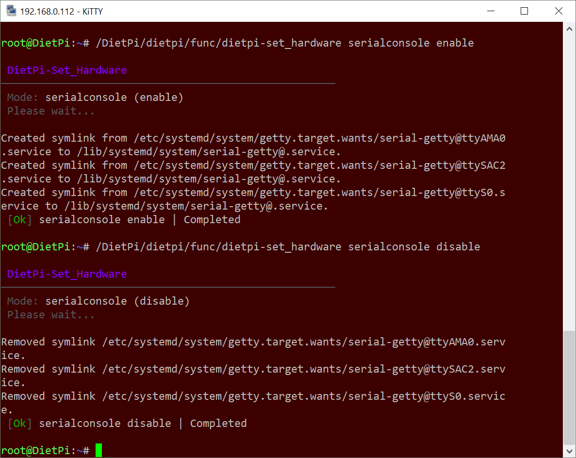

Try running the function script itself:
/DietPi/dietpi/func/dietpi-set_hardware serialconsole enable
/DietPi/dietpi/func/dietpi-set_hardware serialconsole disable
It should result in:

The serial console device is called /dev/ttySAC0 on this device, not ttySAC2
Aha! Lets see if this has any effect on the serial console. Please try running:
systemctl enable serial-getty@ttySAC0.service
reboot
ps aux > /root/attach_enabled.txt
Then same again with disable:
systemctl disable serial-getty@ttySAC0.service
reboot
ps aux > /root/attach_disabled.txt
You should have two files in /root (attach_*.txt), please copy/paste or attach them.

Results attached - the ZIP contains both the enabled and the disabled case.

  • Serial console. if systemctl disable serial-getty@ttySAC0.service has no effect, I believe this may be hard coded as enabled in the /boot binary files. Cant see any config files we can edit. So not much we can do this about this for now.

And finally, regarding serial console: I have now found that it is not initramfs, but the u-boot default environment “bootargs” variable containing a kernel parameter “console=ttySAC0,115200,8n1” that causes a serial console to be created on every boot, and disabling serial console from DietPi to fail.
Unfortunately, I think that there is not much that we can do about this in a DietPi image, as the u-boot environment seems to be stored directly on the device in NVRAM and not on the DietPi SD card. So I think that every NanoPi2/NanoPi3 owner will have to remove this on his own to disable serial console.
