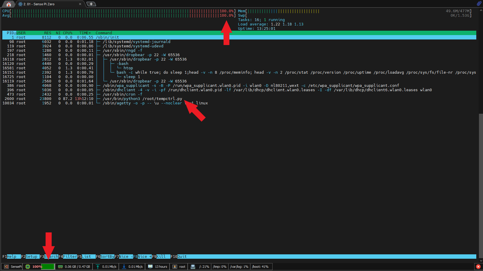

I installed the RPi SenseHAT on a RPi Zero W running DietPi. I created a Python Script to control the Joystick and the LED Matrix Output (code and screenshot below). I added a Service file to have the script start at boot, however the Service is causing the CPU to run at 100% all the time - unless an event is triggered by the Joystick, which brings the CPU usage down. When the event has finished, the CPU usage returns to 100%.
Is this normal? Did I set up the Python Script incorrectly? Did I set up the Service file incorrectly? Is there a better way to have this script run at boot?

The Pi should NOT be running at 100% CPU Usage while Idle
Actual Behaviour
The Pi is running at 100% CPU Usage while Idle, and drops to 5%-20% when SenseHAT Joystick is used.

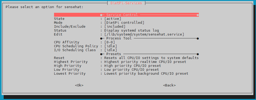

The Script is running via a .service File added to Diet Pi Services. At idle, the CPU stays at 100%.
SenseHAT
Using the SenseHAT Joystick to trigger an event…
When pressing the SenseHAT Joystick to trigger an event on the Sense HAT LED Matrix, CPU Usage drops to around 15% while the script is running an event.
Screenshot of the .service file.
Screenshot of the added Service on the DietPi-Services screen.
how does it looks like if you start the script manually? Theoretically you could start your script using crontab as well Crontab Reboot: Execute a Job Automatically at Boot | phoenixNAP.
I stopped the ‘Service’ and ran the script on it’s own - it’s running at 100% just like before. Which I suppose means that there is a problem with my Python code? See attached screenshots.
