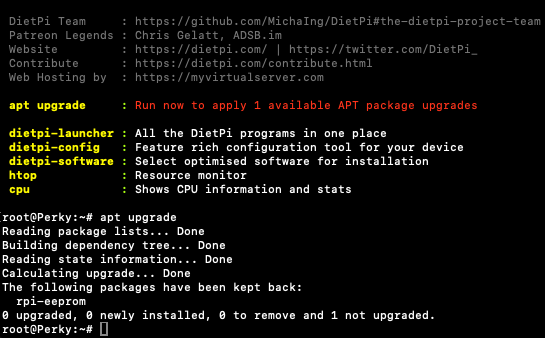

This has been happening for my mum for months and has just started happening for me as well (on both my PIs).
Is this still expected behaviour?
Screenshot 2024-11-25 at 13.55.33
why not checking the GitHub link above?? Or use the forum search?
apt install --reinstall rpi-eeprom
Hi - maybe I misunderstood but I read this comment from you and understood it to mean that it shouldn’t happen anymore:
Sorry of I got that wrong.
edit: I have read through the link and honestly not sure what it is trying to say.
edit2: I did do a forum search which I how I got to this thread, again, sorry.
