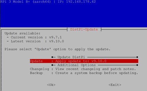

I regularly update my Raspi and this week I found v9.10 to be offered. I tried to update as usual but was asked if I wanted to also do a RPi kernel/firmware migration. I continued with “yes” but only found my system being teleported back to v9.7.1. I didn’t spot an error right away, despite there was no final “update successful, please reboot” confirmation wizard or anything.
I decided to reboot and v9.10 was announced again. I retried, this time selected to do the kernel/firmware migration later. Everything seemed to go through smoothly but in the end the unit seems to stay on v9.7.1.

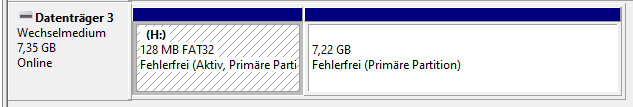

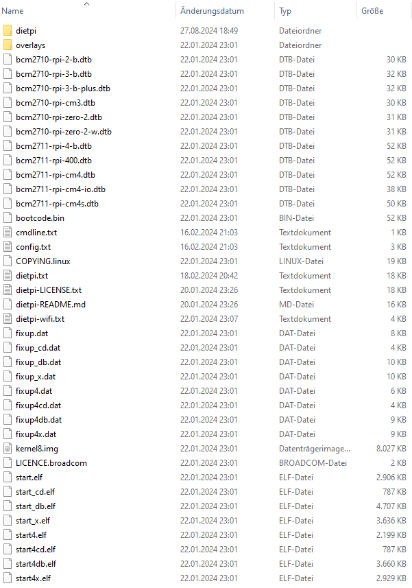

can you try recreating the demo file, switching off the device (not rebooting), removing the SD card from the RPI and checking the contents on a desktop computer? Since /boot is a vfat file system, it should be readable on Windows.
I just tried as suggested. Found only the small 128MB FAT32 is readable…
yes that’s the correct partition. But I don’t see the demo file. So it’s already gone on poweroff.
Can you create a test file on Windows? Once done place the SD card back and check if its available?

So I assume it’s the SD Card dying. I put it into my Windows PC and did the simple test again, created a file, safe ejected the card, put it back in, the new file isn’t present.
Nevermind, I’ll set up a new card and copy anything meaningful.
