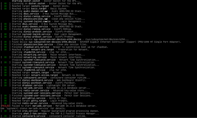

here is a screenshot from the startup after “power on”
with an error message
ok this is a completely different error on boot. There seems to be an issue with MariaDB as well.
